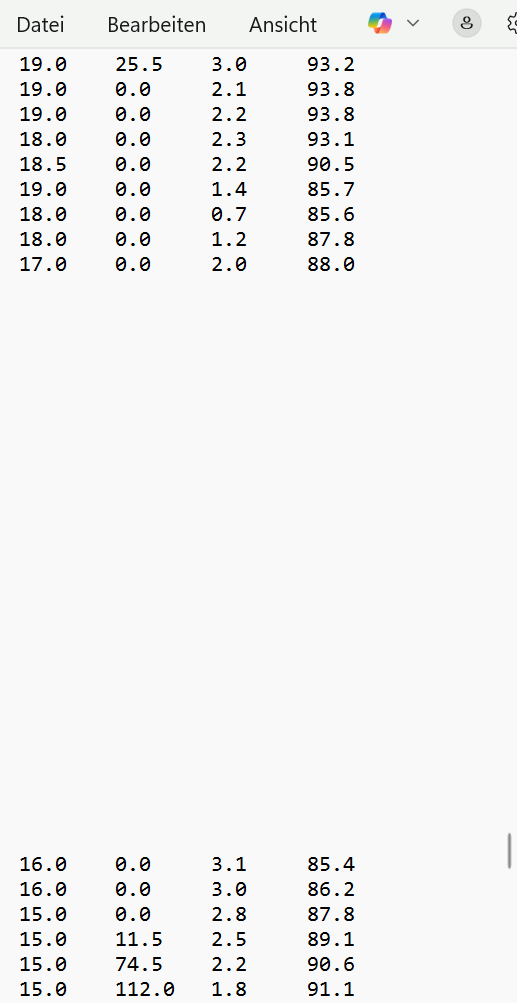

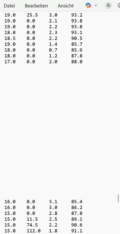

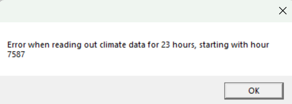

Kavish Chetty Posted October 8 Report Posted October 8 Good Day PVSol Gods, I have been trying to upload climate data to pvsol for the past hour and am not sure what the issue is.Ā Please see the .dat file im working on. and let me know what needs to change. pvsol_formatted_weather.dat Quote
hotline_oh Posted October 8 Report Posted October 8 Dear Kavish Chetty, Thank you for your inquiry. When attempting to import, you receive the error message: After 7587 hours, 23 hours of climate data are missing: We copied and pasted the previous 23 hours. We also changed the country code for South Africa (ZAR --> ZAF). We were then able to import the climate data, and the set appears in the list of data for South Africa. Attached is the file we edited. pvsol_formatted_weather_VAL.dat Quote
