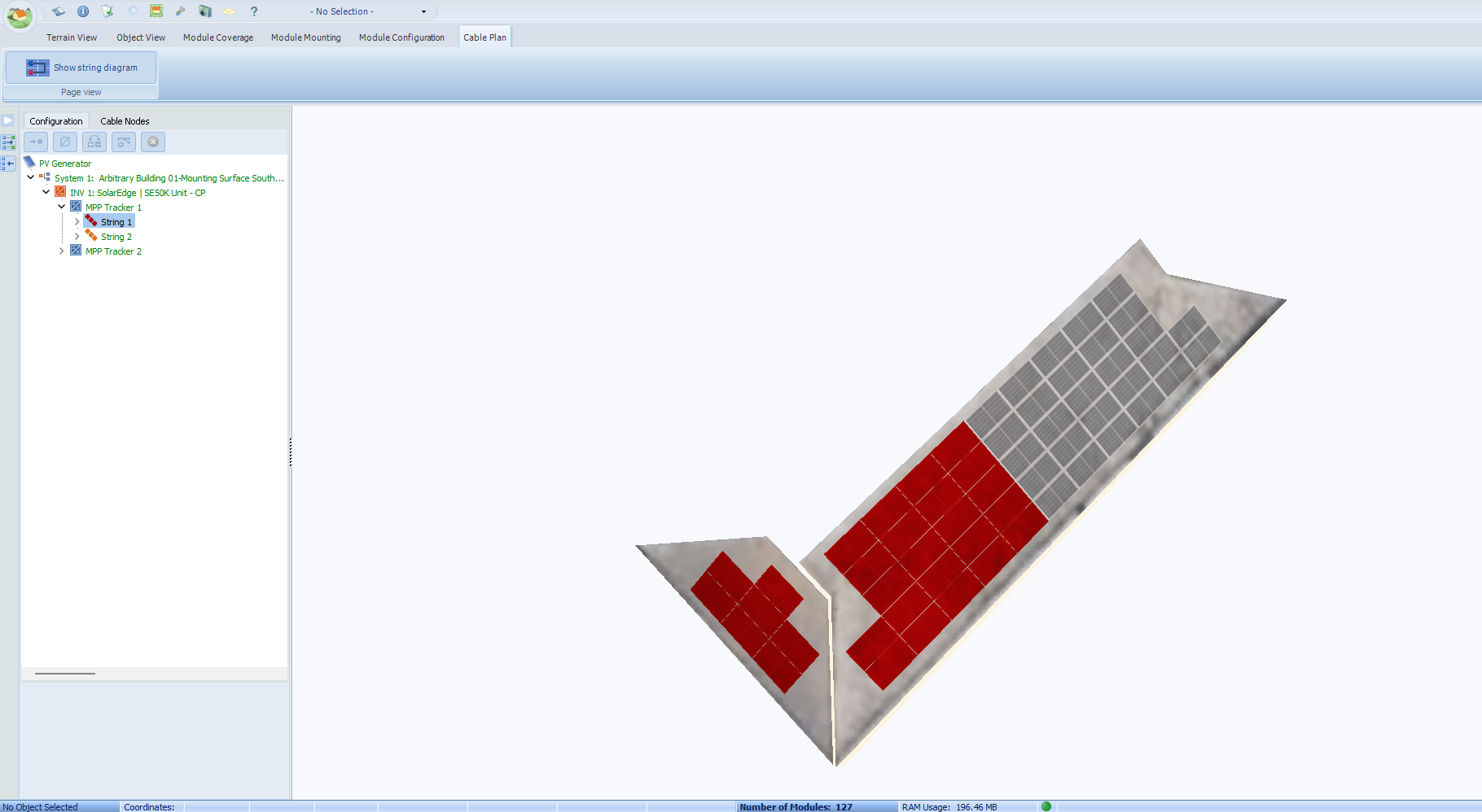

Hello, when stringing a design, is there a way to define the order of panels in a string by clicking and dragging from first to last, like on SolarEdge designer? The only way I've found is to manually click and drag each panel into the right place, but on larger designs this is very time consuming as the panels you drag swap places, so you can end up having to move every panel in the string to get the right layout. I know there is also the small menu in the bottom left where you can choose direction, starting point and course, but these generally need manually adjusting.

in addition to the two methods you already mentioned (predefining the sort order in the small menu on the bottom left and manually sorting them by dragging), you can draw the cables with a pen in the cable plan section.
I made a small screen cast to show what I mean. If that is not what you are looking for, please feel free to ask.

Unfortunately, the cable diagram is not available for roof-spanning wiring (as in your case), polystring wiring, or elevated systems.
Instead, a string diagram is available, based on the sorting on the Module Configuration page.
