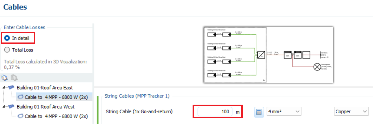

hotline_oh Posted June 2, 2025 Report Posted June 2, 2025 Dear CarlSEL, Thank you for your inquiry. If you select detailed dimensioning on the ‘Cables’ page, the separate losses for the DC and AC cables are displayed in the energy balance: Quote
CarlSEL Posted June 3, 2025 Report Posted June 3, 2025 I was asking about the AC cables. I have 25 330k inverters all with different lengths ranging from 100 metres to 300 metres. There is no way to manually input each cable length. Quote
hotline_oh Posted June 17, 2025 Report Posted June 17, 2025 Dear CarlSEL, Thank you for the clarification. We have passed your request on to our development department once again. Quote
