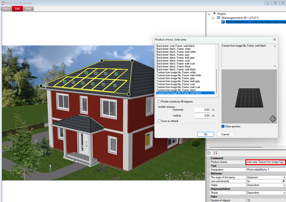

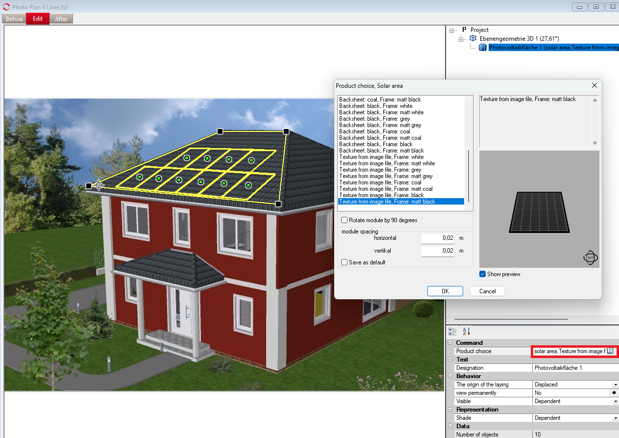

When i choose a known black panel in photoplan, it doesnt show up as black. I can only choose black frame. Is it possible to fix the colour to match the panels? Or make it possible to Chang  the colour of the panel like in the 3D configuration?

On 5/10/2021 at 10:27 AM, developer_fw said:
Hi patrik k,
sorry for the late response. Could you send me the "original" picture from PhotoPlan here or via private message? Thank you in advance.
Best regards,
Frederik
You can change the colour of the frames in PV sol, is it much work for you to also implement it on the colur it self
Hi patrik k,
the problem here is, that PhotoPlan is external software that was bought by us a long time ago. Due to the age there is no maintenance and neither do we have the source code nor do we have permission to change anything. This is why my standard answers refer to bitmap manipulating.

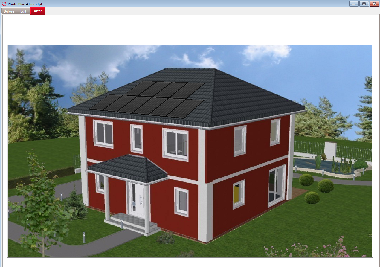

I tried a bit, there is no recipe, but with brightness, contrast and some colour variation, you could achieve this:
Best regards,
Frederik
