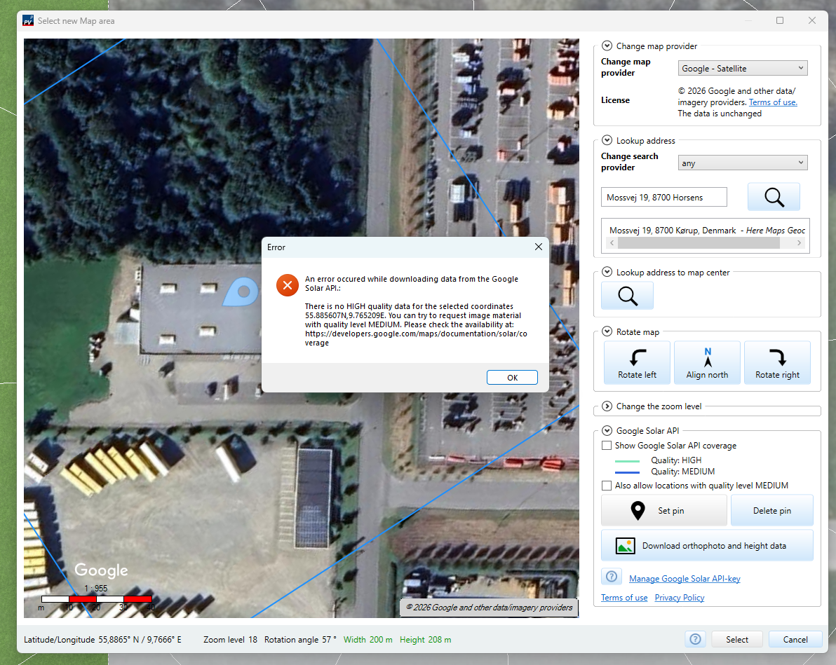

Anders Posted Wednesday at 09:53 AM Author Report Posted Wednesday at 09:53 AM Okay. thank you. I have now got a API key. But I get this error when i try to download orthophoto. Why? Quote
Anders Posted Wednesday at 10:06 AM Author Report Posted Wednesday at 10:06 AM Hi again. I’ve figured it out now. I checked the “medium” option. I’ve now created the project with the Google API. The report says it’s only 0.1% reduction in yield due to shading. Can that be correct? Have I created the project in 3D correctly? Dagrofa Horsens - Kopi.pvprj Quote
