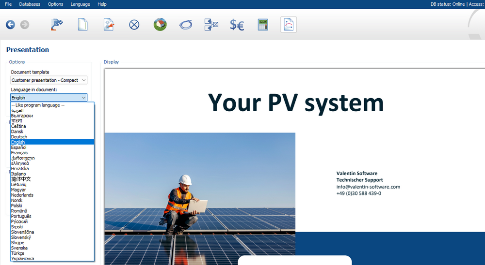

Anders Posted Friday at 08:25 AM Report Posted Friday at 08:25 AM Hello. I want to change the headline in the compact customers presentation. For now it says "Dit PV system" How do I do that? Quote
Anders Posted Friday at 11:21 AM Author Report Posted Friday at 11:21 AM I would also like to now if I can change the picture on the front page in the compact rapport? Quote
Anders Posted Saturday at 07:06 AM Author Report Posted Saturday at 07:06 AM Can I change the headline and the image on a compact report? I would like to change the headline “Your PV system.” Quote
Anders Posted Monday at 07:51 AM Author Report Posted Monday at 07:51 AM Hello. Can I change the headline and the image on a compact report? I would like to change the headline “Dit PV-system.” Quote
hotline_oh Posted Monday at 08:47 AM Report Posted Monday at 08:47 AM Dear Anders, Thank you for your inquiry. Unfortunately, editing the cover page of the compact presentation is not possible. You can export the compact presentation as docx file and then edit everything to your liking in Word. We will forward your request to our development team. The heading can be changed to "Your PV system" by selecting English as the document language. 1 Quote
DSchwer Posted Monday at 09:30 AM Report Posted Monday at 09:30 AM Hi Anders, you can change the image used at the start of the compact report by replacing it in your installation files. Open the installation path of PV*Sol 2026 and go to Images there you can find the file TitlePageImage_ShortReport.jpg. Rename the original one, instead of deleting it. You then can use any other image by naming it exactly like the original was named and place it in the same path. Be careful using this workaround, since the size of the image is used "as is" and is not automatically fitted to fit the report. You have to play around with the size a bit, to get a good look or just use the width and height of the original image. Since this workaround is not supported it might break at any time of course. 1 Quote
