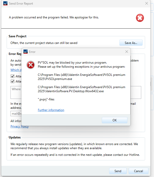

Ryan PSE Posted January 13, 2025 Report Posted January 13, 2025 Hello, since the 2025 release I am having issues with loading PVSOL Premium, I will get the error saying it is being blocked by antivirus but all antivirus software has been set to allow the program through. The 2024 version works fine, and after a while the 2025 version will start working normally without changing anything, but usually the first thing in the morning I get stuck trying to open the 3d visualisation, have to close and reopen the software multiple times until it will just start working. Is there any idea what I can do about this? It's happening to both of our users in the business. Thanks Quote

Fabian Grundler Posted September 22, 2025 Report Posted September 22, 2025 Hello, the bug still exists in PV*SOL Premium 2025 R10. Bug report was send on the 16th of September. Machine is running Windows 11 Pro on an Intel 11th Gen i5-1185G7. @developer_bh is there a general solution available to this issue? Best regards, Fabian Quote
hotline_oh Posted September 23, 2025 Report Posted September 23, 2025 Dear Fabian Grundler, Thank you for your inquiry. The following files must be classified as safe in your antivirus program: C:\Program Files (x86)\Valentin EnergieSoftware\PVSOL premium 2025\ValentinSoftware.PV.Desktop.Wow6432.exe C:\Program Files (x86)\Valentin EnergieSoftware\PVSOL premium 2025\PVSOLpremium.exe If you can confirm that all antivirus software has been set to allow the program through, please send us a bug report and provide the exact time of the bug report so we can identify it. Quote
Fabian Grundler Posted October 2, 2025 Report Posted October 2, 2025 Without classifying any files, but (re-)associating the *.prj files with PVSOLpremium in the windows setting the error message didn't show up anymore. 1 Quote
