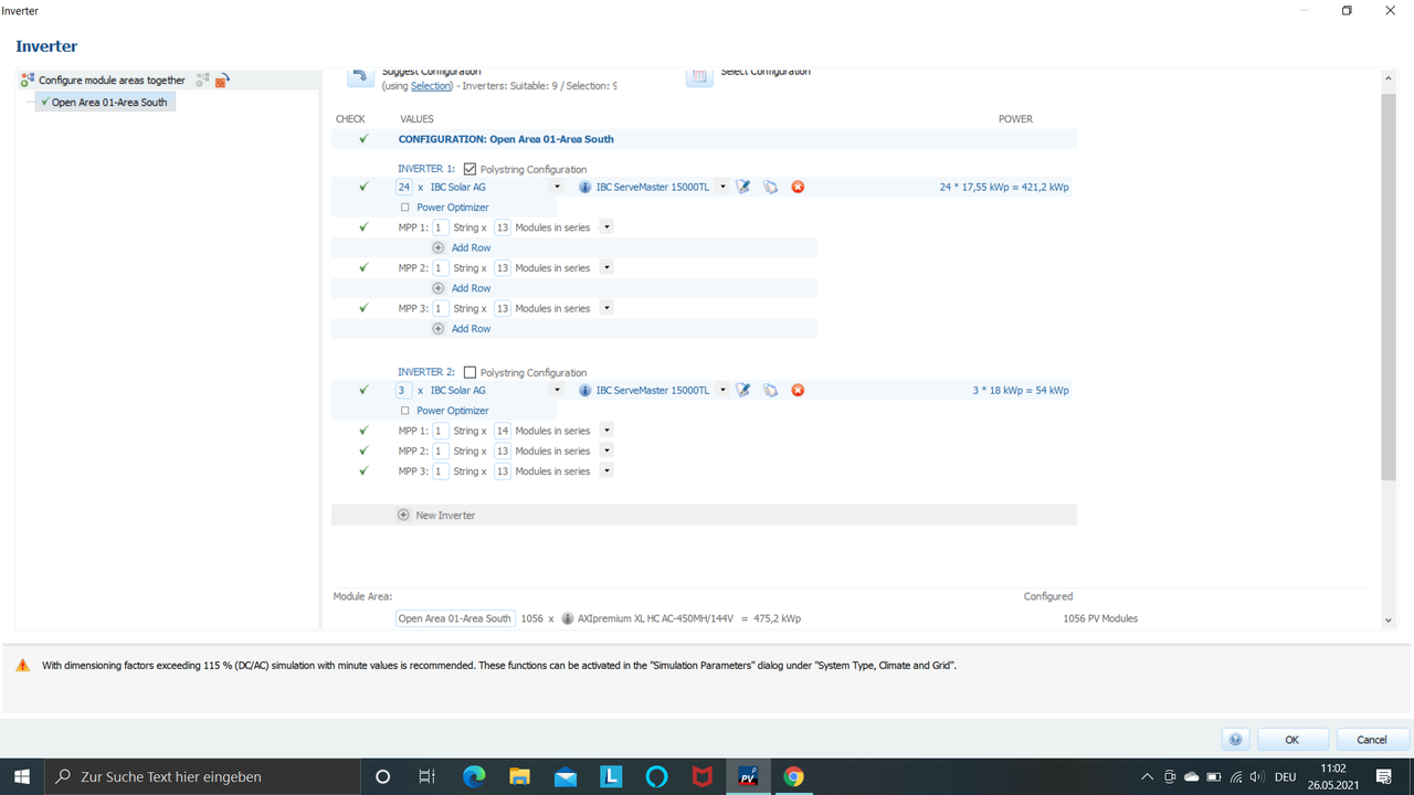

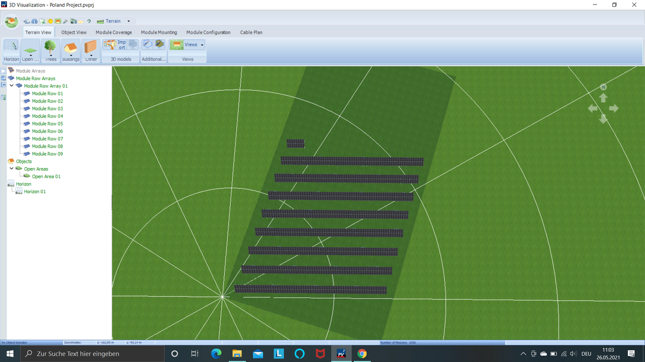

Sunny Posted May 26, 2021 Report Share Posted May 26, 2021 Hello Team, i am planning use minimum number of Inverter for my large solarpark (0,5 MW) which has around 1056 Solar panel. how should i set the string and series so i can use minimum number of inverter(5 to 7). i tried with SMA,Sungrow,huawei invters but it take 40 inverters for this project. i got a suggest configuration of IBC Solar AG inveter but it also take 27 inveter. can you please help me to find solution that how can i set a strings?. Quote Link to comment Share on other sites More sharing options...
developer_fw Posted May 26, 2021 Report Share Posted May 26, 2021 Hi Sunny, the automatic configuration has got its limits. Have a look at the model SMA Sunny Tripower CORE2 e.g., which offers a high number of MPP trackers and is able to consume high input powers. You should be able to realize your project with 5 inverters of this type. Best regards, Frederik Quote Link to comment Share on other sites More sharing options...
