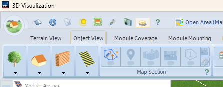

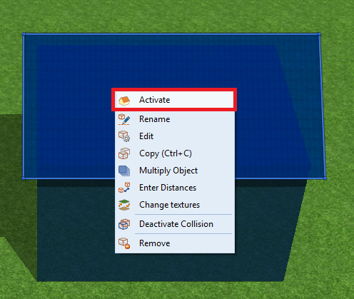

You have to be in the "Object View" - Tab to see this right-click option. It does not work in any other view, especially "Module Coverage", which confused me in the beginning.
