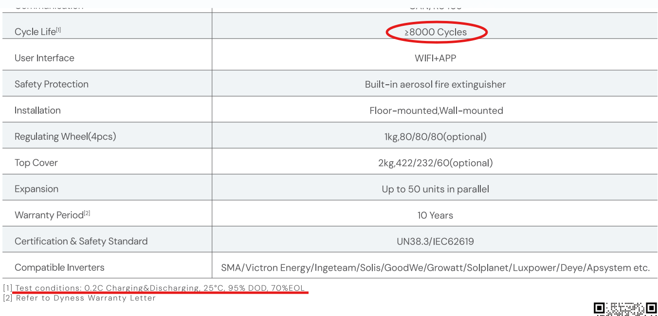

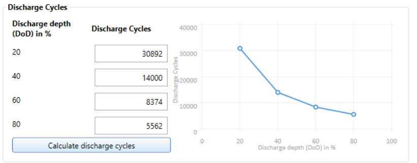

Good Day, I want to make sure if my calculations are correct. I added a Dyness PowerBlock Max 16kWh battery to the database. Please just check if my Discharge Cycles are correct below:

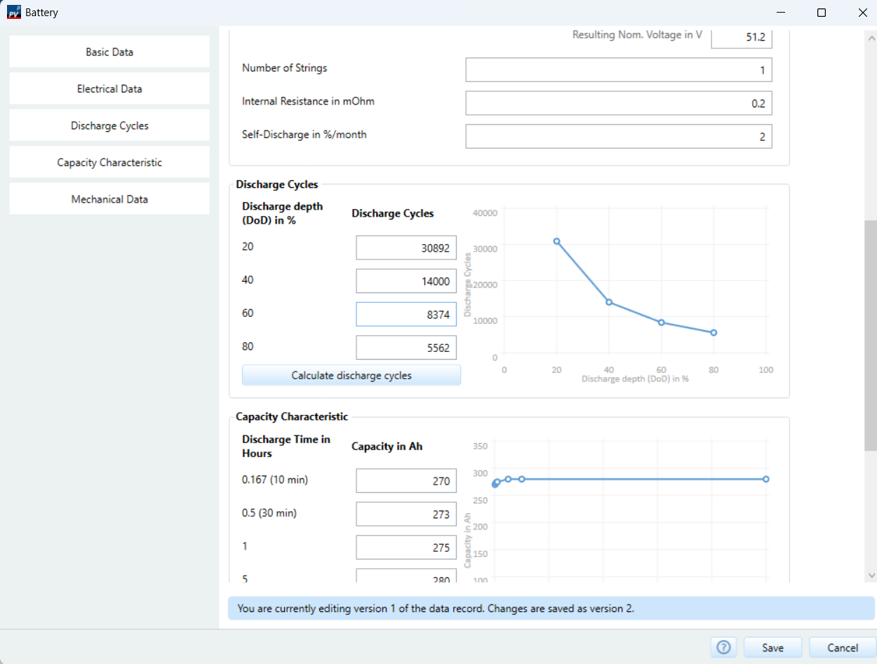

When I try to change the value at 60% DOD to 10000 and do the Calculate cycles then that value just returns back to the values that it was. Nothing changes.

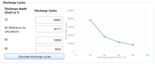

We apologise: for lithium iron phosphate batteries, the reference value used to calculate discharge cycles is not a DoD of 60% (as with lead-acid batteries), but a DoD of 40%.
You can simply enter these four values manually:

For lithium iron phosphate batteries, the reference value used to calculate discharge cycles is based on a DoD of 40%. This results in the following factors for the discharge cycles:
DoD
Value
0.2
2.206563
0.4
1
0.6
0.598166
0.8
0.397315

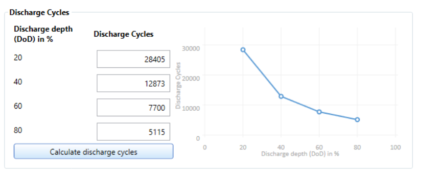

Good Day, my question was actually, what the formula is to calculate the battery DOD at 40%. As per below, it does not reflect what you are getting.
