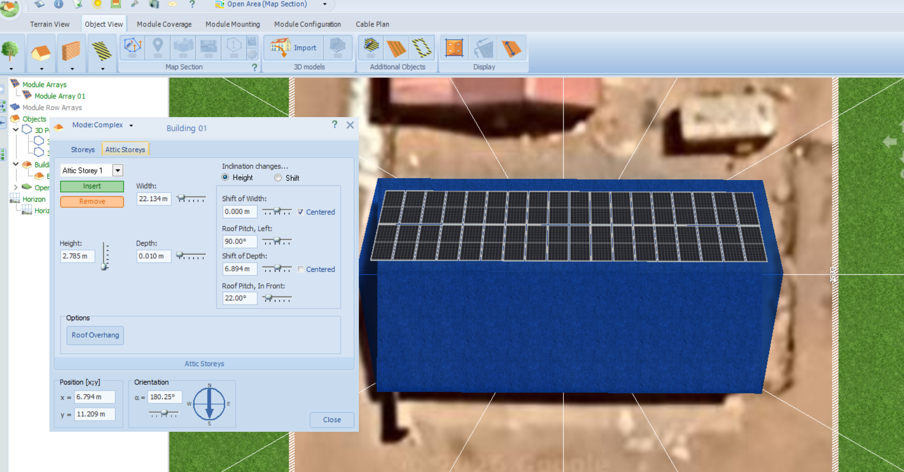

Good Day, How do you change the Roof Pitch or Roof Angle without deleting any configurations?
And also, why is the inclination not the same as the Roof Pitch when my system is setup for flat roof mounting?

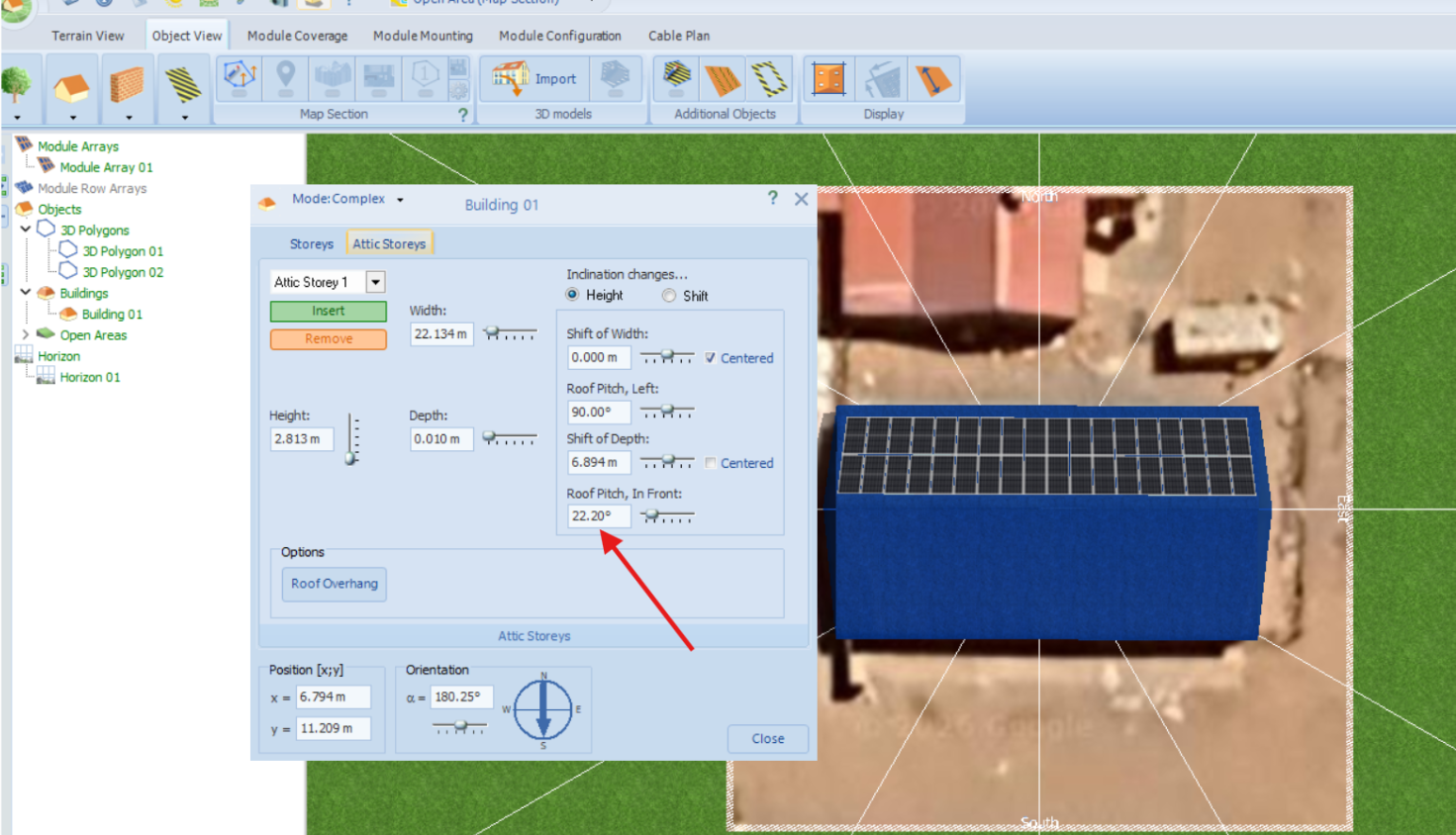

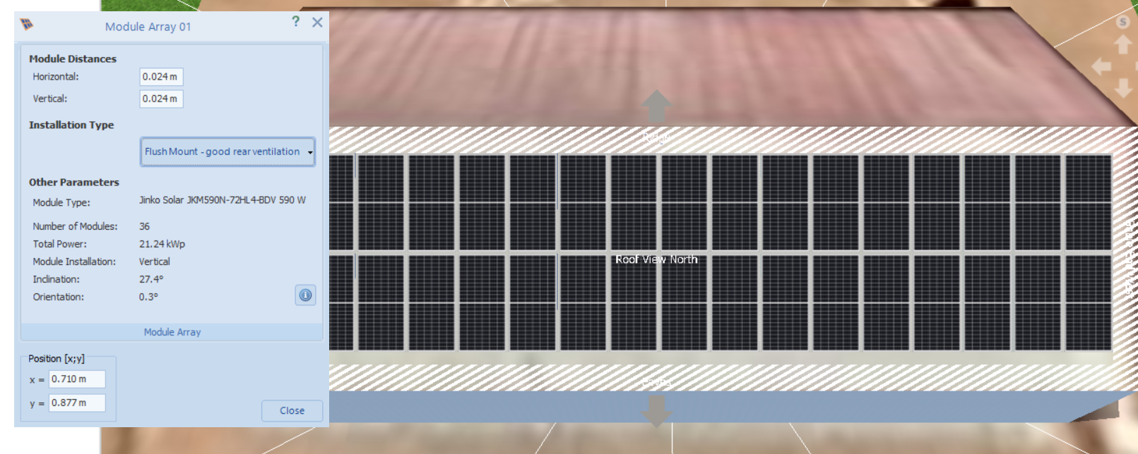

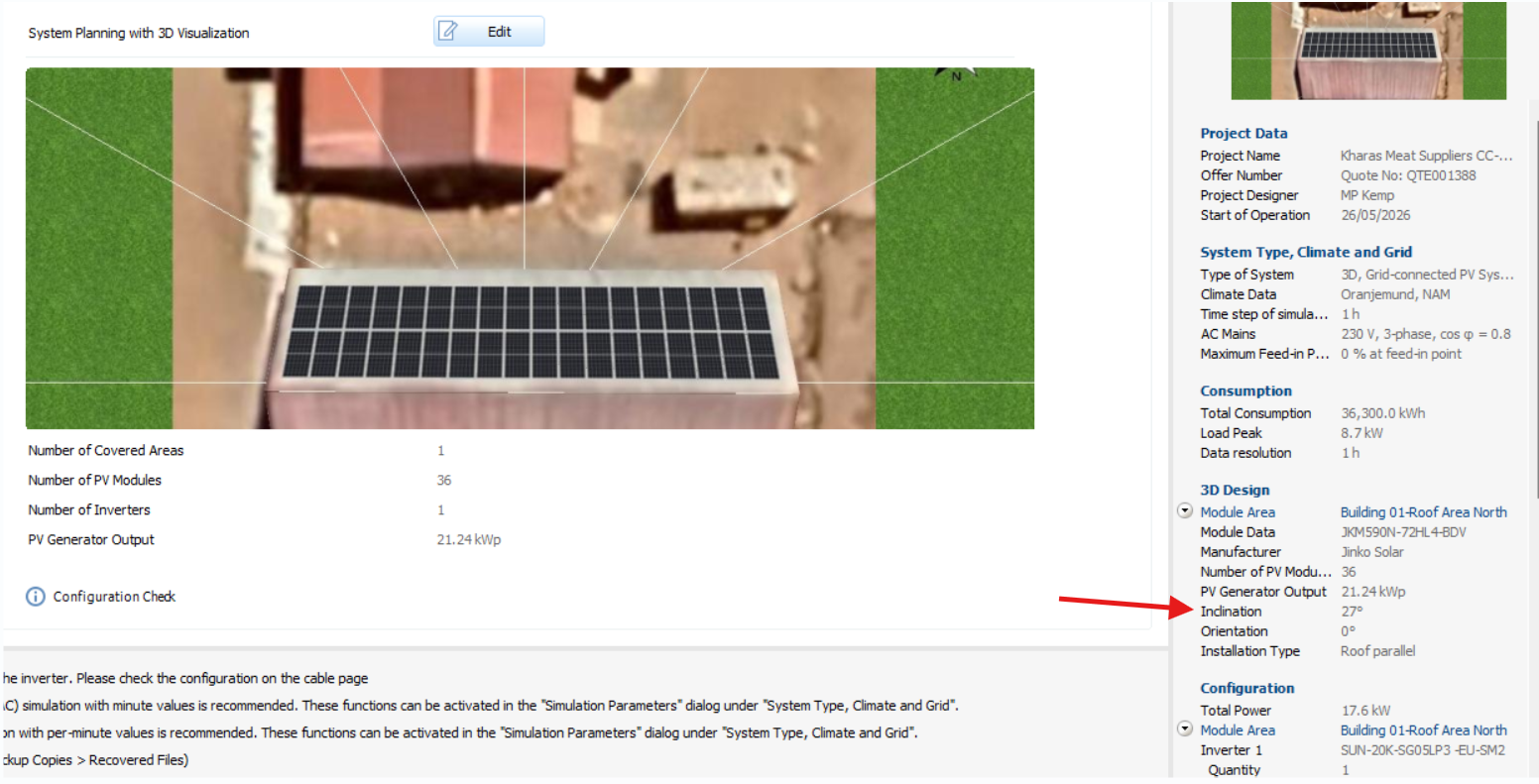

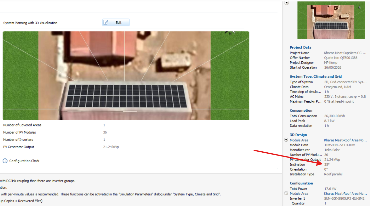

Hi, why is the Inclination showing 27° when my Roof Pitch/Angle is set 22°
My Installation is Flush Mount as per below:
