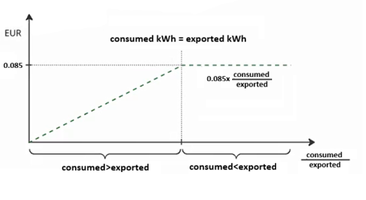

According to these rules, if the consumer takes less energy from the grid than they send to it, the price of the exported energy is €0.085/kWh.
If the consumer sends more energy to the grid than they consume from it, then the price of the exported energy is calculated using the formula:
0.085 × (consumed / exported)

If possible, please send us the source of the diagram.
Thank you for your response. Currently in Croatia, under the new regulation, the surplus feed-in billing method is in effect (as I mentioned). The calculation is done on a monthly basis. This means that consumed energy is charged at €0.16/kWh, while the energy sent to the grid is calculated according to the specified formula (the more you send, the lower the price).

I made sketch of diagram.
I made sketch of diagram. So, there is no solution for new regulation, the surplus feed-in billing method in Croatia?
