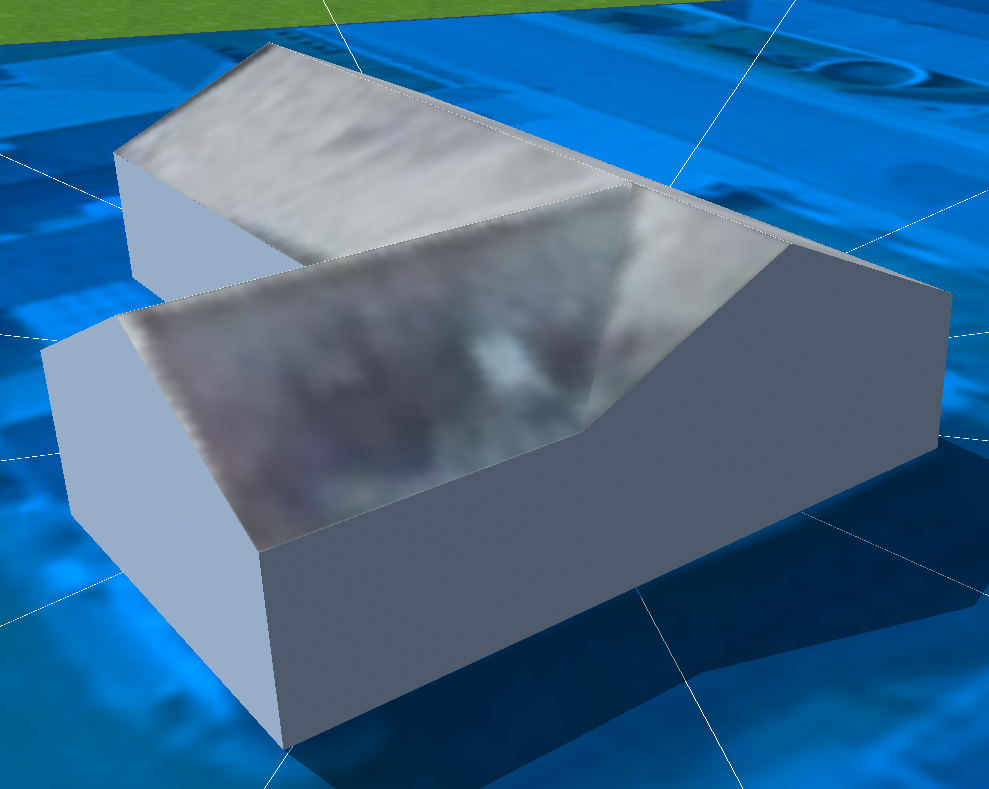

Can you help me with my 3D project. I want to draw the house in 3D. I don’t know how to draw the house with the angled extension where the roofs intersect. can you explain?

To create this L-shaped building, draw several polygons and extrude the buildings one after the other. You deactivate the collision (right-click on the roof) and move the buildings towards or into each other.
This tutorial explains how to draw an L-shaped building. To watch the tutorial in English, you can select the "English" audio track in the YouTube settings.
Please find enclosed the project file we have edited.
