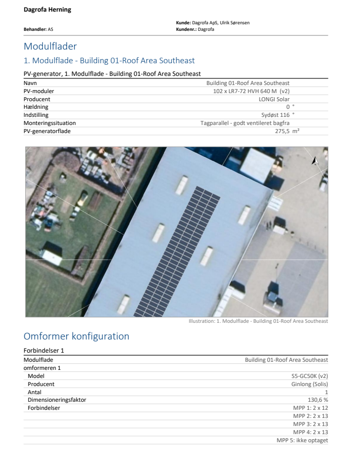

Anders Posted Thursday at 10:46 AM Report Posted Thursday at 10:46 AM Hello I know how to change the image on the project overview page. But how do you change it on the module surfaces page so i can see all the PV moduls? I would still like to keep south pointing downward, so that it is not rotated like the overview image. Thanks. Dagrofa Herning.pvprj Quote
hotline_oh Posted 7 hours ago Report Posted 7 hours ago Dear Anders, Thank you for your inquiry. We took another screenshot in the screenshot manager: This one will be included in the project report: The project file we edited is attached. Dagrofa Herning - VAL.pvprj Quote
