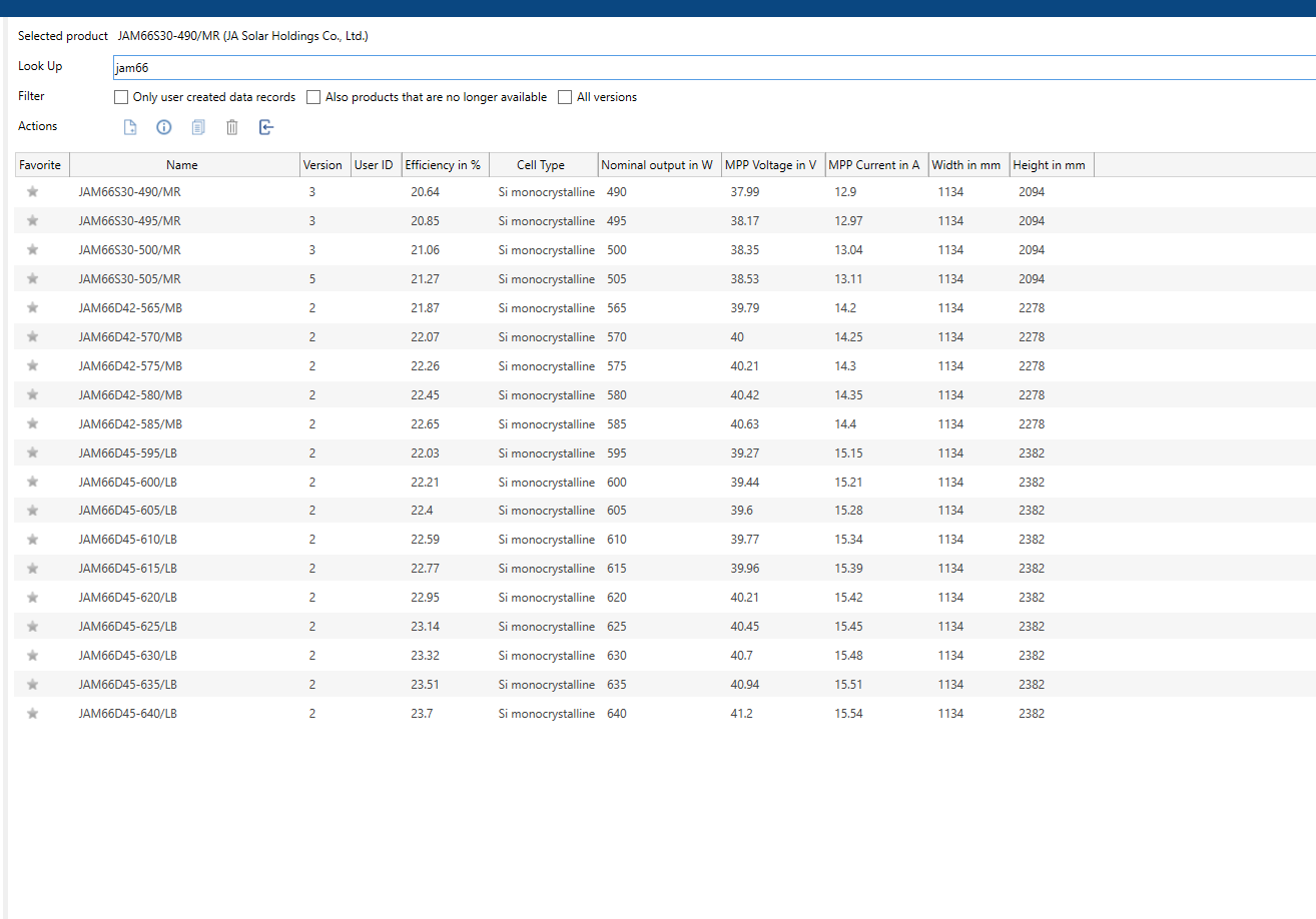

The database is maintained by the manufacturers. They have access to an online database where they can enter their products. We update the database regularly and transfer the new entries to the user databases.
We will contact the manufacturer and ask them to add the missing modules.

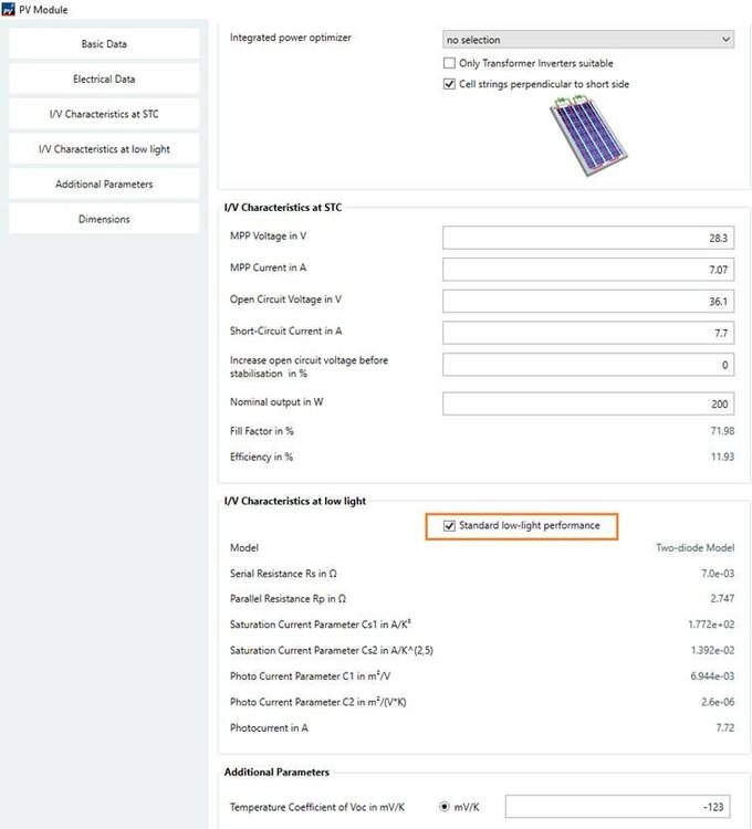

In PV*SOL you also have the possibility to create products by yourself. The easiest way is to copy an existing dataset and overwrite the values using the datasheet.
Since there is no information available on the datasheet about the low light performance, you have to select standard.
