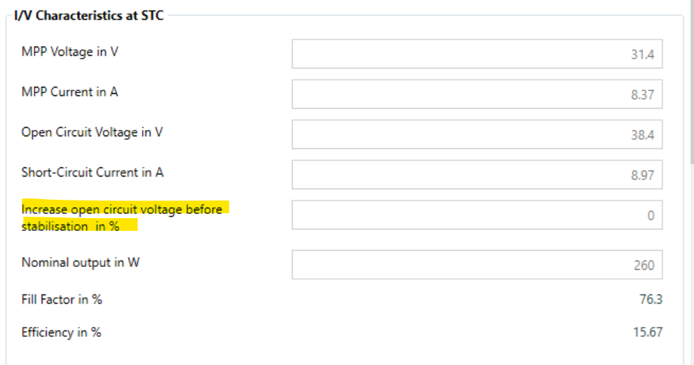

No. There is kind of the inverse value, the increase of the open circuit voltage before stabilisation:
But this factor is not applied in the simulation, only during the configuration check.
