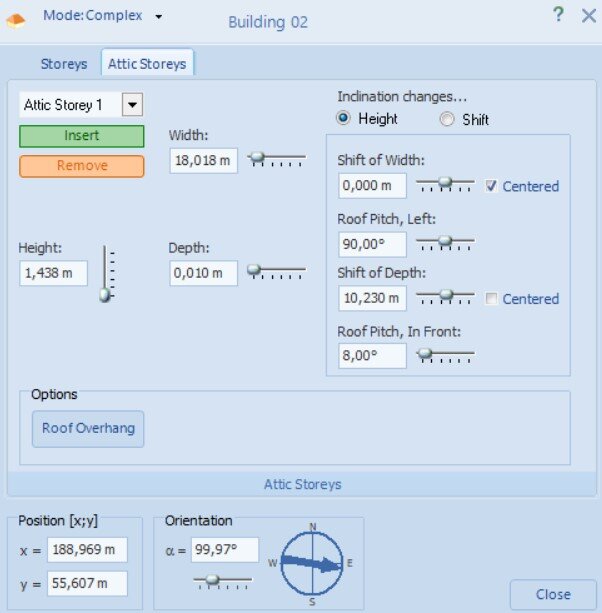

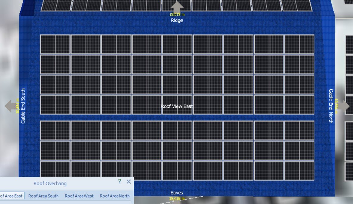

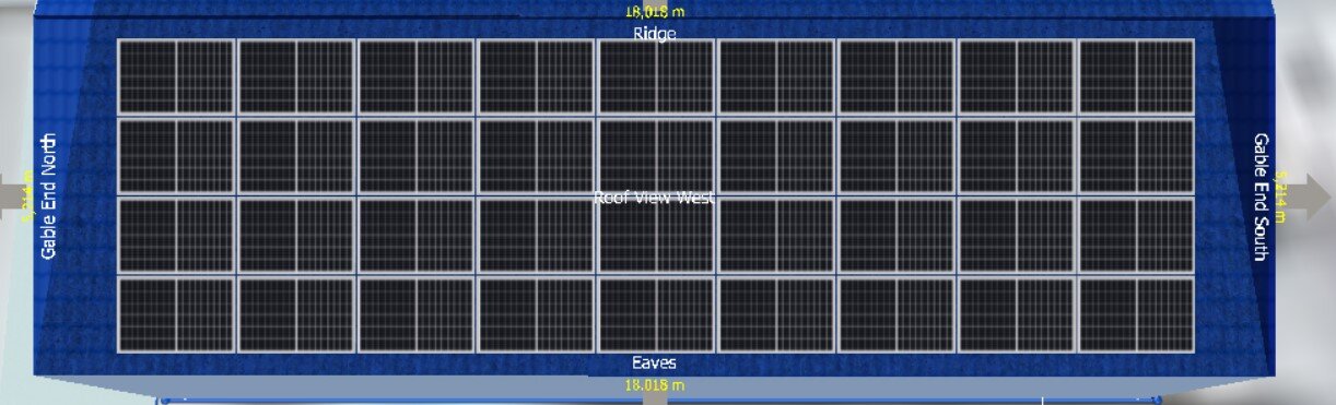

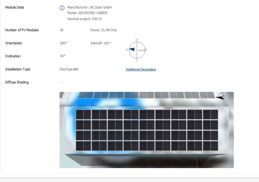

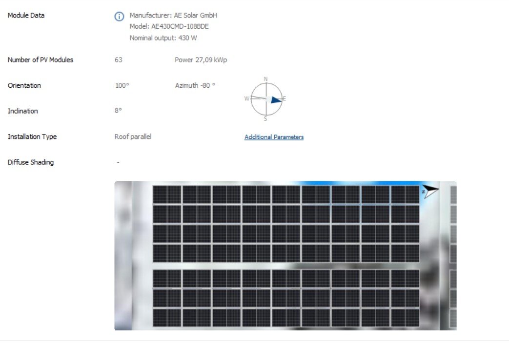

I have a problem with roof inclination. I want to have both wings of the roof to have 8 degrees inclination. Here are my settings, but one wing appers to have inclination 16 degree and the other is 8 degree. How could I fix this? The ridge is not centered.
Thanks in advance,
Gordana
Dear Gordana,
If you have an off-center ridge and both sides of the roof are pitched at 8 degrees, that means you have two different eave heights, right? Unfortunately, you can't represent this with a gabled roof, as a gabled roof can only have one eave height. You would have to represent this building as two sub-buildings, each with a pitched roof (pent roof), then you can represent the different eave heights (and the shared 8-degree pitch).
