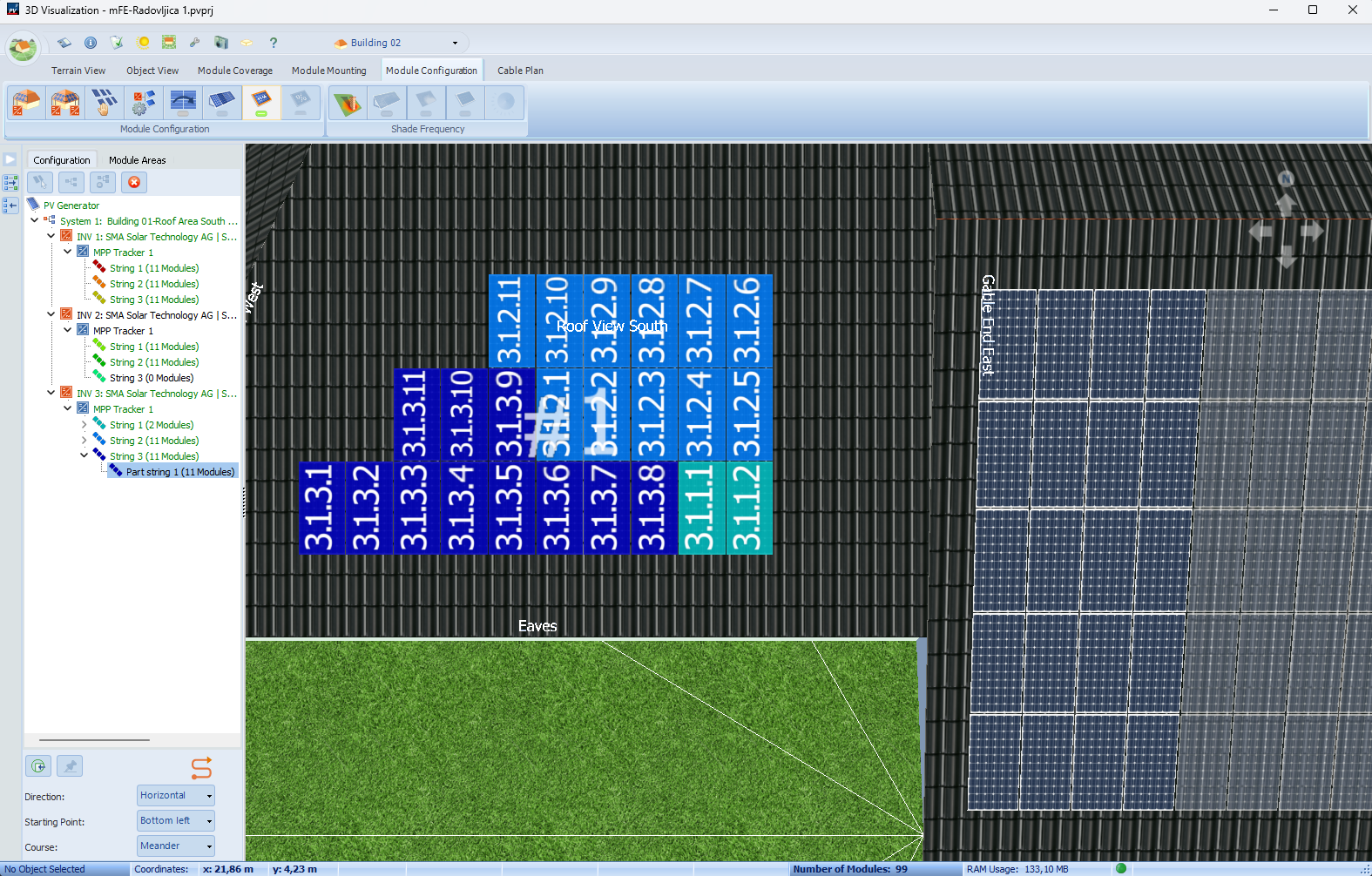

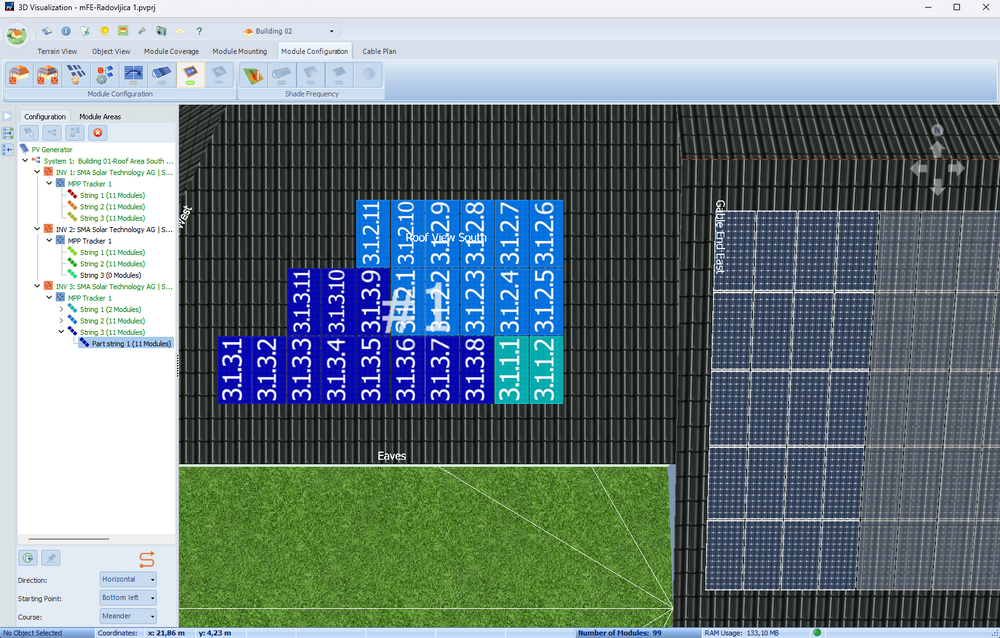

I have specific issue. I have two roofs with PV modules (75pcs + 24pcs) and 3 inverters (33pcs per inverter). Two of them are on roof 1, third one on roof 2 which uses 24 modules and other 9 on roof 1. On third one polystring configuration is used. The issue occurs when I try to allocate modules manually. I can do it for some modules but then after allocation of 5x 11 strings on roof 1, the other modules are freezed and unable to select/allocate them. What can I do? Additionally, module counting seems not to work properly.
Matija
PV.SOL_issue_5.png?csf=1&web=1&e=nIbyVO
Dear Matija,
To define where you want to place which modules in a polystring interconnection, it is best to use the "Define Module Areas" dialogue, which is described here.
If you need more detailed instructions, please send us a drawing of how the modules should be sorted and/or your project file (*.pvprj) by private message or email to hotline@valentin-software.com.
