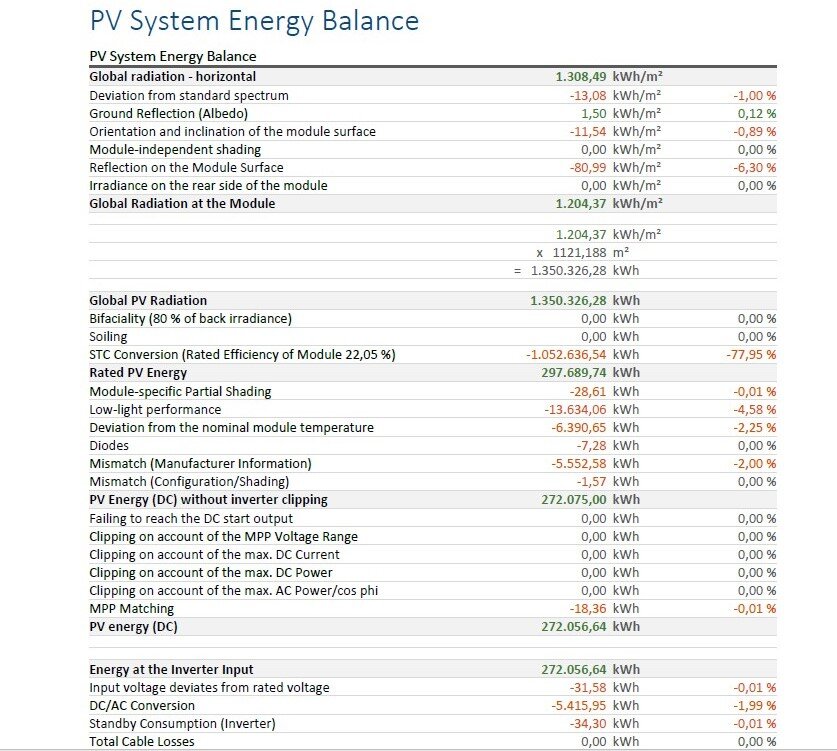

July 8, 20251 yr comment_19411 Dear admins, I have a question regarding performances of the system that I have created. I manually set in the program which inverters will be used, the string lengths, and their connections to the MPP inputs. The system is functioning, and there are no errors, but I don’t know how to assess whether the system’s performance is satisfactory. If there are any parts with significant losses, or any problematic spots, considering that I configured everything manually, please tell me. Also, if you could point out the fields I should check when manually setting the inverter selection and string connections, I would appreciate it. Thank you in advance, Gordana Report
July 8, 20251 yr Author comment_19412 10 minutes ago, Gordana said: Dear admins, I have a question regarding performances of the system that I have created. I manually set in the program which inverters will be used, the string lengths, and their connections to the MPP inputs. The system is functioning, and there are no errors, but I don’t know how to assess whether the system’s performance is satisfactory. If there are any parts with significant losses, or any problematic spots, considering that I configured everything manually, please tell me. Also, if you could point out the fields I should check when manually setting the inverter selection and string connections, I would appreciate it. I worry about this STC Conversion -77,95%, but I don*t know if it is related with cable plan, because I didn*t configure cables. Thank you in advance, Gordana Report
July 14, 20251 yr comment_19457 Dear Gordana, Thank you for your inquiry. Your PV System Energy Balance looks fine. In our view, there are no particular anomalies, not even in the STC conversion. A module efficiency of 22 per cent is plausible. We recommend that you take a look at our example projects: Alternatively, you can create several project files with different modules and different inverter configurations and use the project comparison to compare the simulation results with each other: Report
