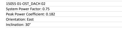

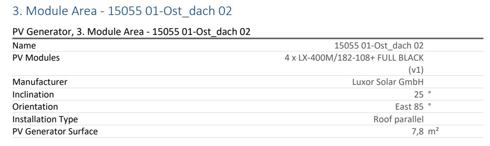

I have designed and simulated a project but there are some problems in the report.
the inclination of the actual roof and the boundary conditions are different as an example
This is the inclination i have in my module areas but i have a different inclination in my Yeild for EnEV simulation result.
It should be 25 degrees but instead i have 30 degrees.
I have also faced the same problem in different projects . How do I solve this problem?
Thanks for the support in advance!
Posted
Hi Rohith,
the results according to EnEV are based on very rough calculations. For example the inclination angle only has the possible values 0, 30, 45, 60 and 90 °. There are a lot of other limitations as well, so you should pay much attention to those numbers. You only need(ed) them for some German subsidy programs and the like.
