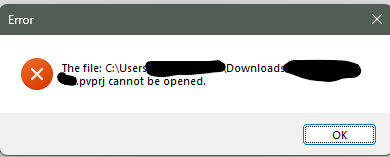

Chloe G Posted June 16, 2025 Report Posted June 16, 2025 Hi there, I have the same issue where I cannot load a .pvprj file sent to me, what is the cause of this? I have PVSol Premium 2025 screenshot of error message below (sensitive data redacted): Quote
developer_bh Posted June 16, 2025 Report Posted June 16, 2025 Hey Chloe, is the file accessible? In the path I see you use OneDrive, which might be unavailable from time to time. To rule this possibility out it would be helpful if you copy the file to your desktop f.e. and try to open it from there. Best regards, Ben Quote
Chloe G Posted June 16, 2025 Report Posted June 16, 2025 Hi Ben, Just downloaded it and tried to reopen, same error message: Quote
developer_bh Posted June 16, 2025 Report Posted June 16, 2025 Hey Chloe, thanks for the fast response. I guess the project is not from a different version (like f.e. PVSOL unpremium vs PVSOL premium)? If you press CTRL+L you can see the log. Is there an entry regarding the failed load? Best regards, Ben Quote
Chloe G Posted June 16, 2025 Report Posted June 16, 2025 Hi Ben, from the log I can see the following: 2025-06-16 11:19:02,826 [7392|8|Load] Load() - error during unzip. Not all files available. Anti-Virus? Many Thanks, Chloe Quote
developer_bh Posted June 16, 2025 Report Posted June 16, 2025 Hey Chloe, can you send me the project file via PN? Which version (2025R6?) of PVSOL have you installed? Best regards, Ben Quote
