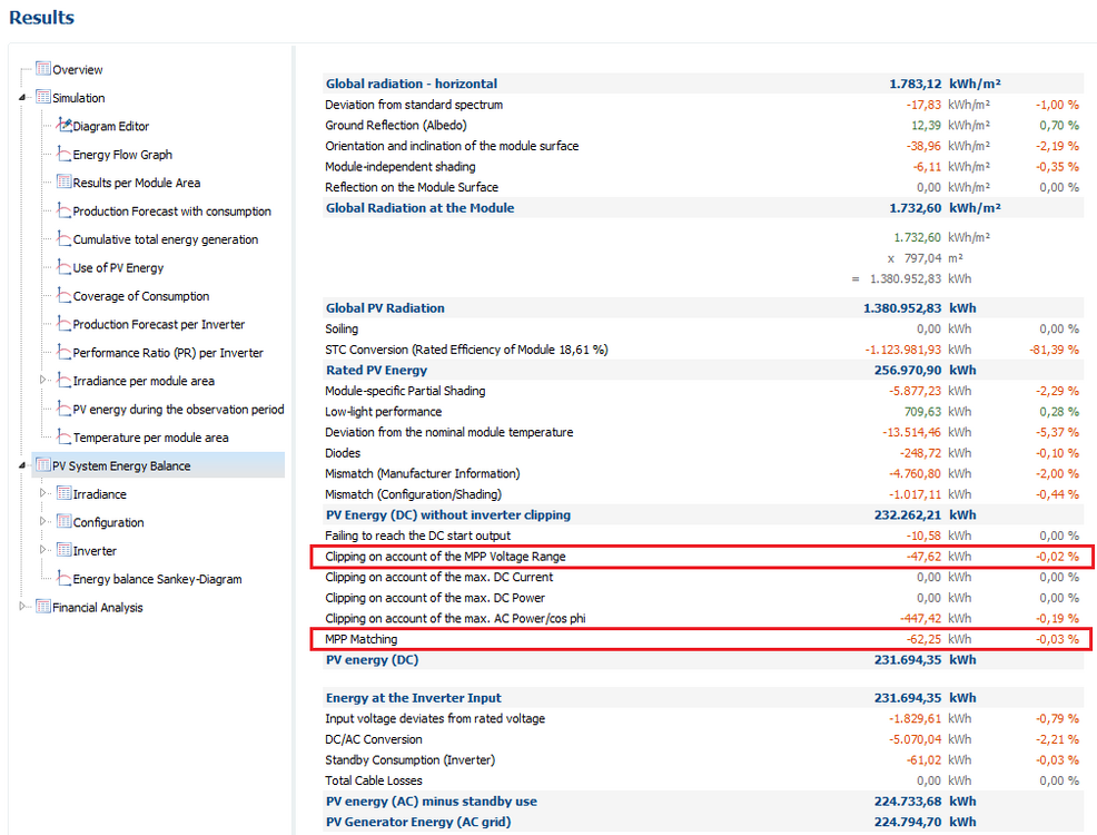

  • Energy losses resulting from the MPP tracking process are shown in the energy balance:
