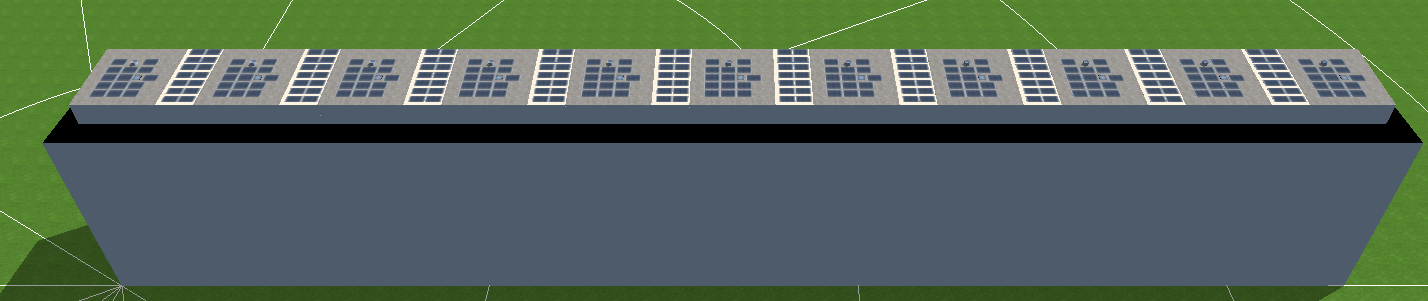

I'm fairly new to PV*SOL. I'm working on a project, with multiple technique rooms on top of the building, spaced evenly out. I have modeled each technique room individually as well as the space between these, as we are considering whether to place the PV in between. I've modelled everything an placed the PV modules, but now I realize, that the building doesn't have the correct orientation
Rotating each building doesn't really work that well, as you can see 😅 Is there a different way of doing this? The easiest would be, if it was possible to change the orientation of the site.

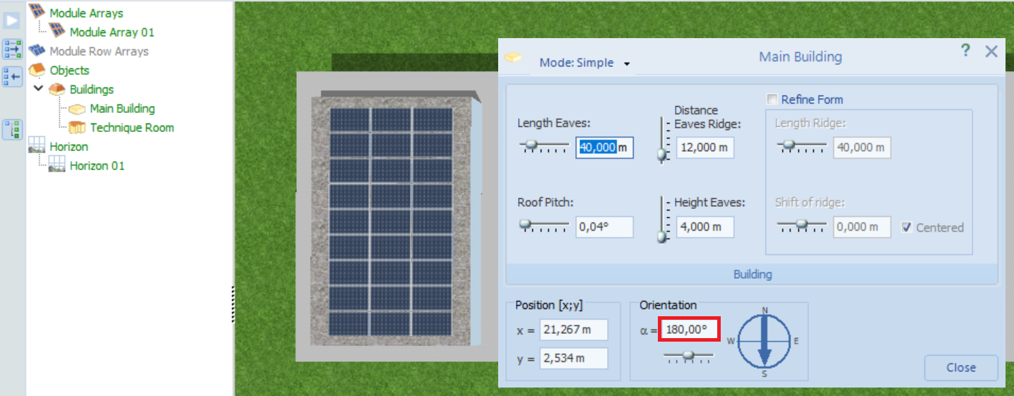

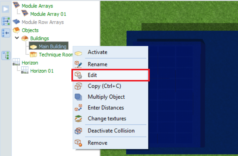

You can rotate the main building by right-clicking on it in the tree view on the left, selecting "Edit," and entering the new orientation:

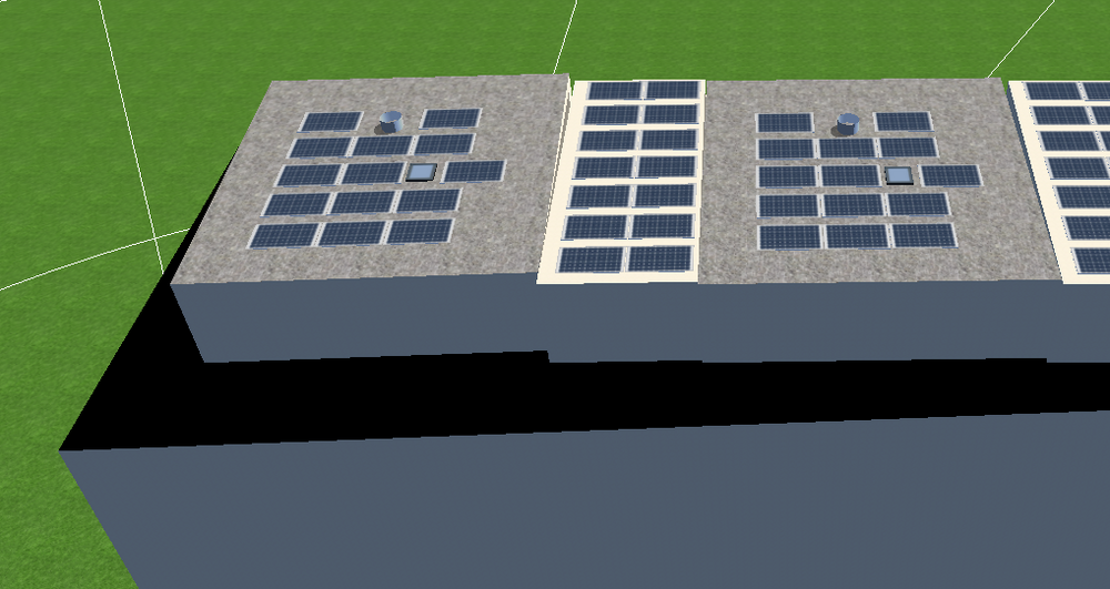

Rotating them one by one doesn't work, as each building is "pinned" in the corner to the given coordinate. That's what I was trying to show on this image. And finding the specific base coordinate for each building part will be a living hell 😅
