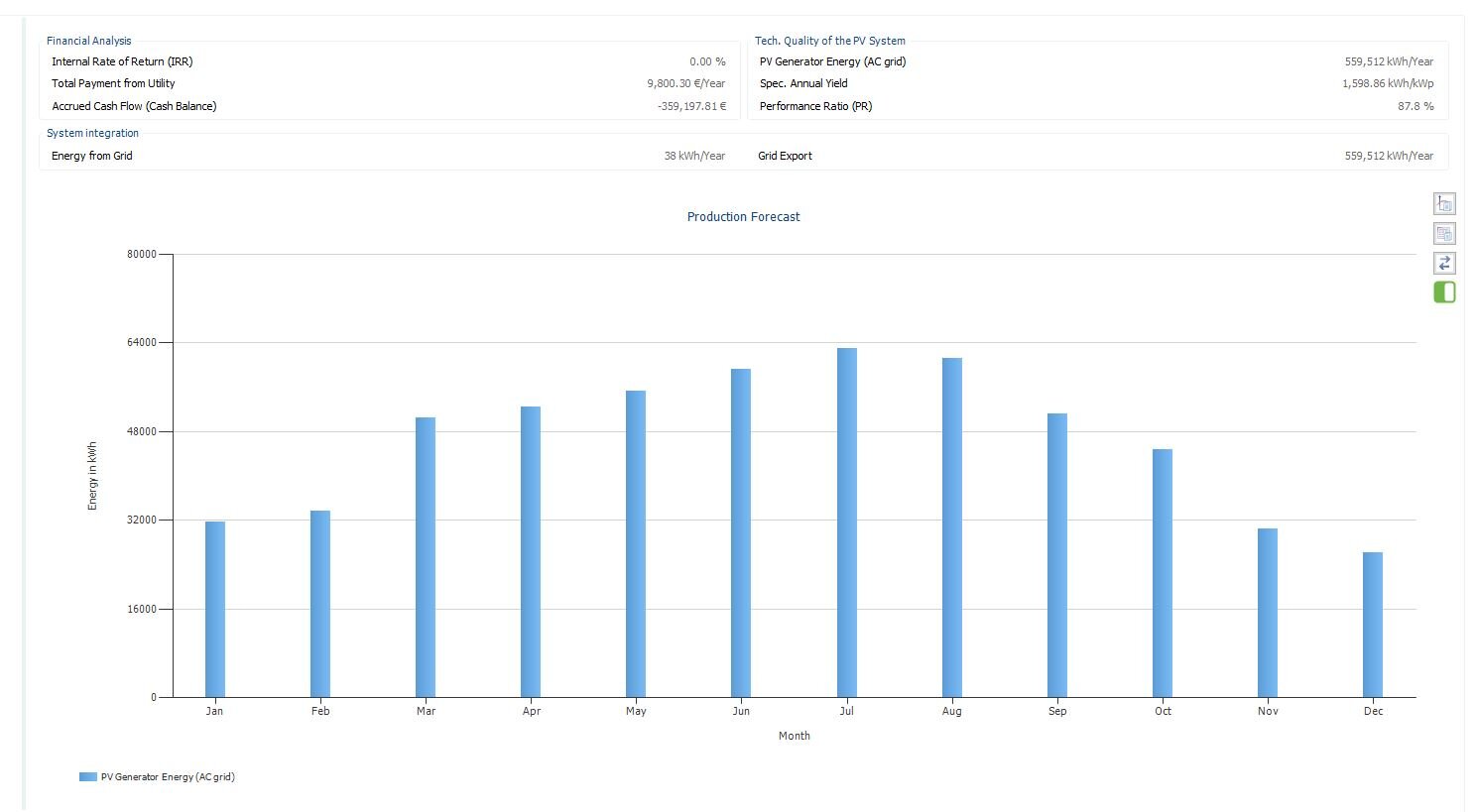

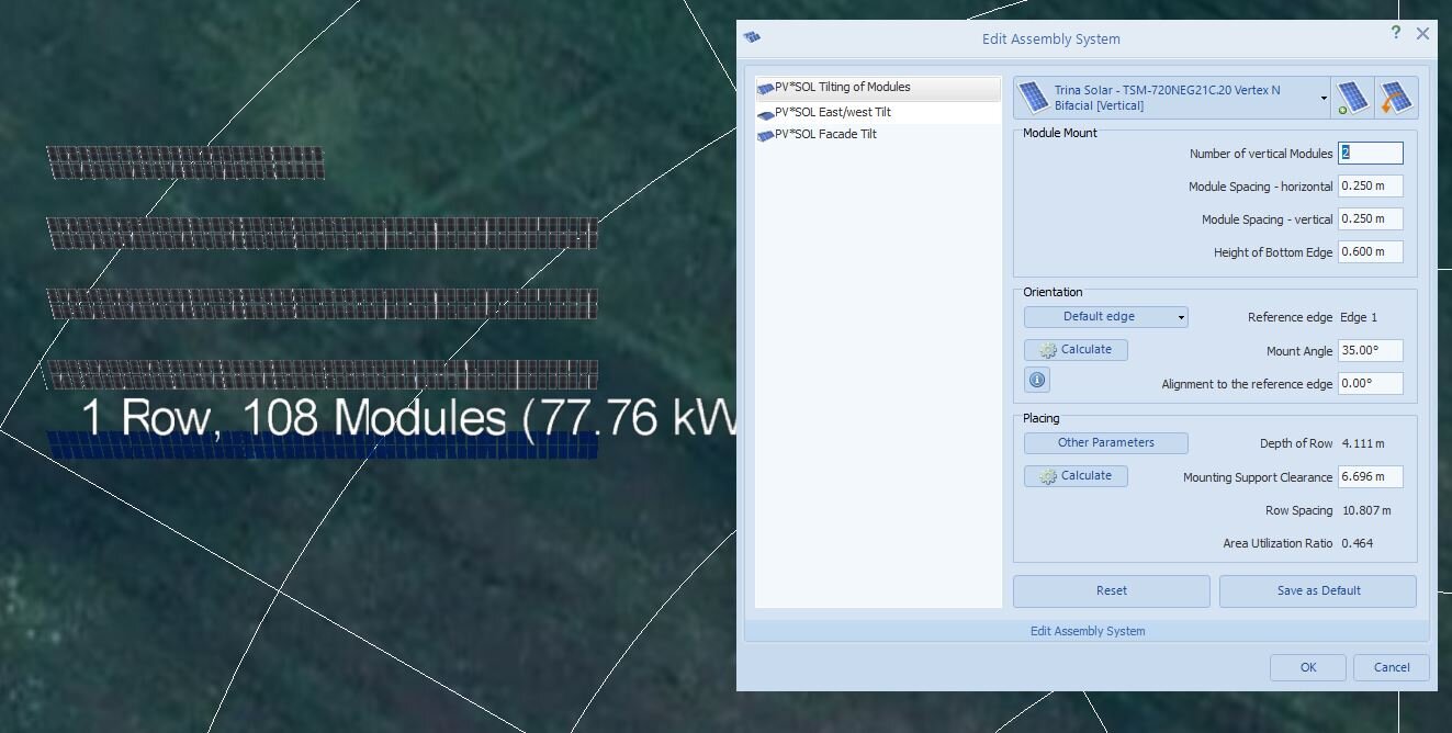

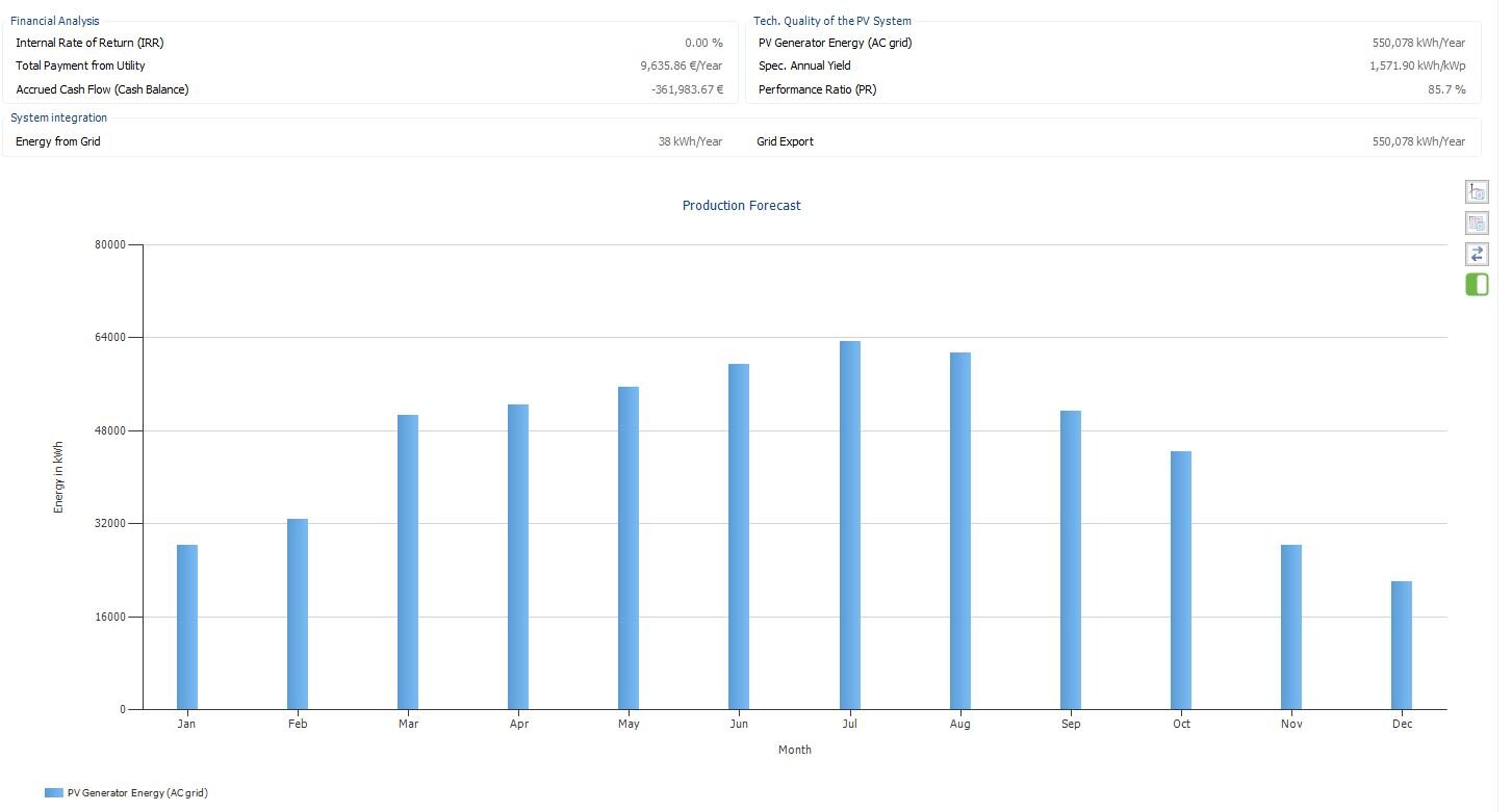

In the 2D planning, shading is not taken into account (unless you manually enter a percentage value). We suspect that the 3D planning shows slight shading due to the elevated module rows, which is why the yield is slightly lower.
Please feel free to send us both project files (*.pvprj) to hotline@valentin-software.com so we can take a closer look.
