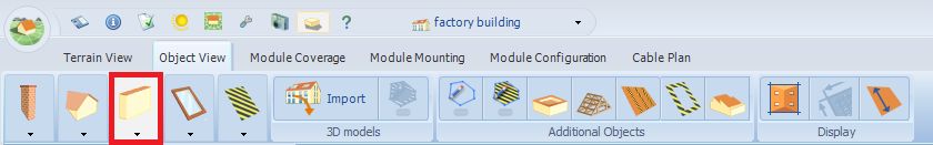

Instead of an attic, you have the option of inserting fireproof walls:
It is correct that the software does not automatically detect mounting surfaces. You import a 3D model as the building envelope and must manually define where mounting surfaces are located. Please also refer to our FAQs: What should I consider when importing 3D models?
