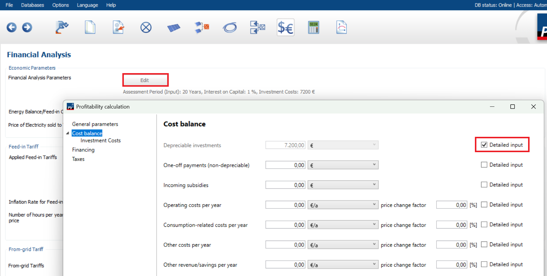

When i add a battery to the system i cannot find a way to increase the value of the job.
Currently were using £650 per kw but when you add a battery that cost is not taken into account.
any ideas, please?
Hi Dave,
Our PV software cannot calculate costs. Component prices and other costs are not included. You must determine the costs of your planned system yourself. The calculated system price is entered into the profitability analysis and thus forms the basis for the financial forecast. The forms in the "financial analysis" module are pre-populated with sample values and do not represent average or empirical values. You must adjust these to suit your specific project.
You can enter the detailed investment costs here:
