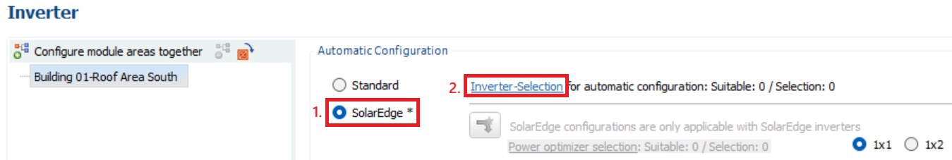

Select the ‘SolarEdge’ configuration option and first pre-select the inverter(s):

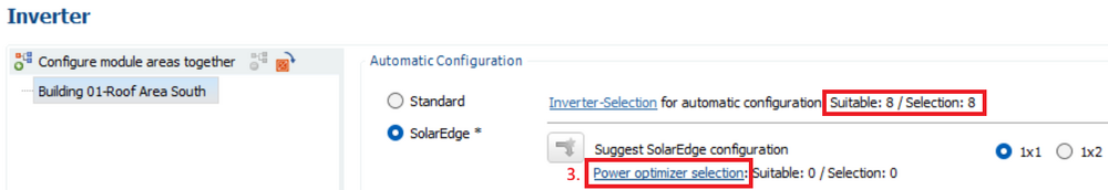

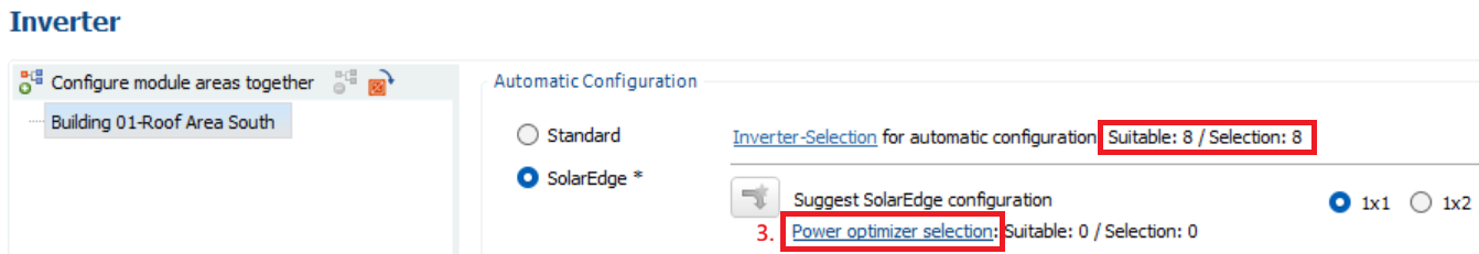

Then pre-select the power optimizer(s):

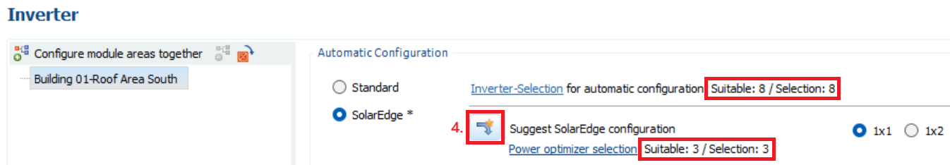

You can then use the button, which is now active, to generate an automatic configuration proposal featuring SolarEdge inverters and SolarEdge optimizers:
