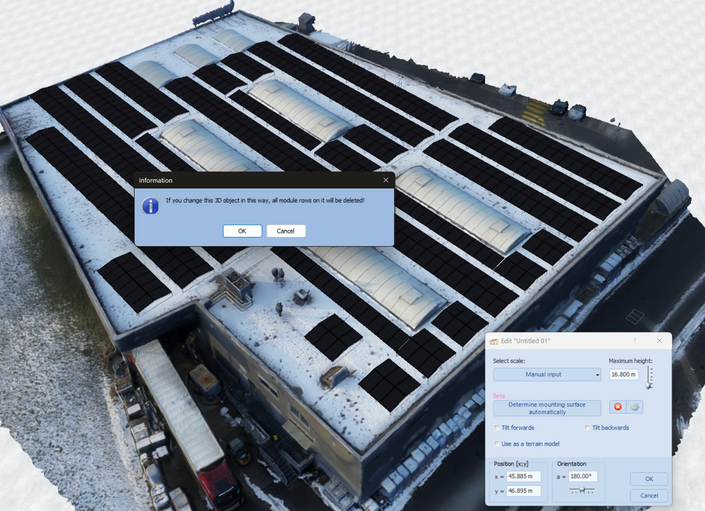

i do have one more quick question. Is it possible to rotate the project afterward, including the modules? I keep receiving a message that the module rows are being deleted. I assume this means that rotating the project afterward isn’t supported and that there is no workaround—but I wanted to check with you to be sure...
Dear Lime,
If you need to rotate a building retrospectively, the existing configuration is only retained for roof-parallel systems. For elevated systems, the configuration is unfortunately deleted. The wiring is deleted in both cases.
