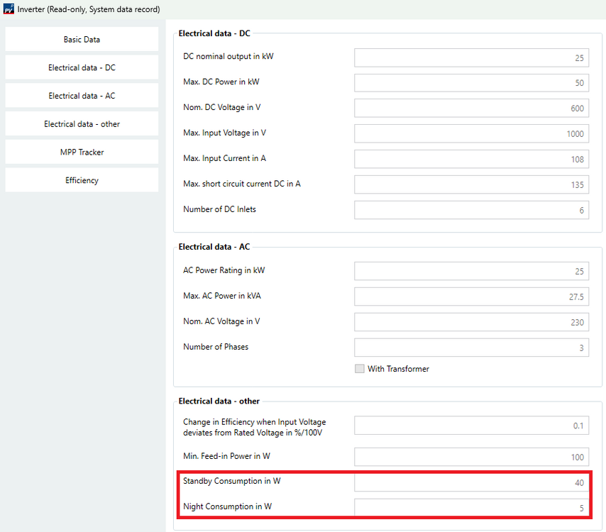

am working on a grid-tied with batteries project, and idk why there alwayes a grid consumption, no matter how small the load is compared to the PV or the battery
Is there a way to force load to consume from the battery first, or to prevent the grid import

Dear said allaw,

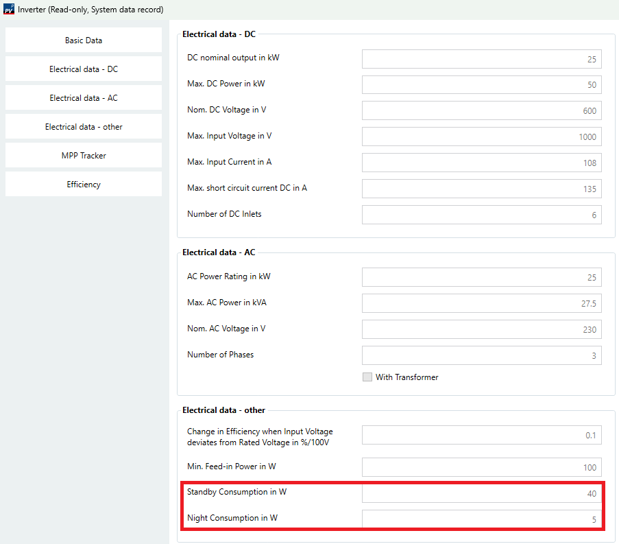

The inverter SolaX X3-ULT-25K is stored in our database with a standby consumption of 40 W and a night consumption of 5 W. This energy is drawn from the grid.
You have the option of copying the inverter data record and setting the standby consumption and night consumption to zero. Then no energy will be drawn from the grid.
