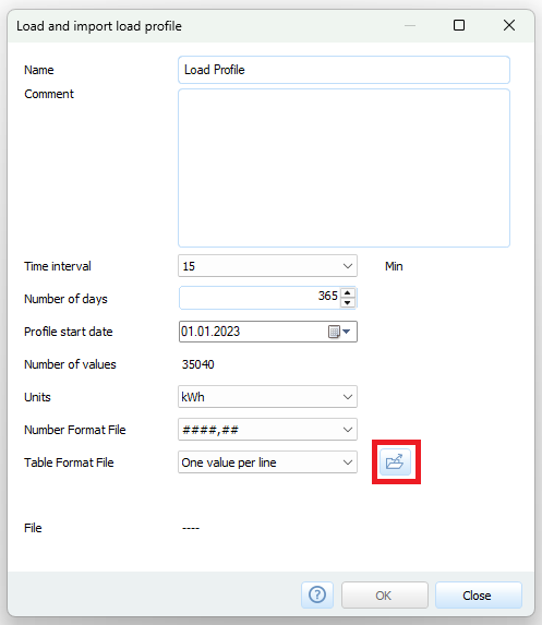

You can import the load profile (consumption data in kWh, 15 min, one year) as a CSV file. Information on how to do this can be found in our online help. You only need the consumption values, without timestamp and column header, in the first column of the CSV file. The file must consist of one column with exactly 35040 values (4*8760).
