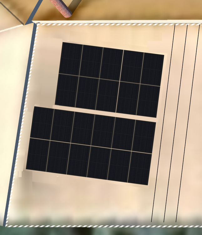

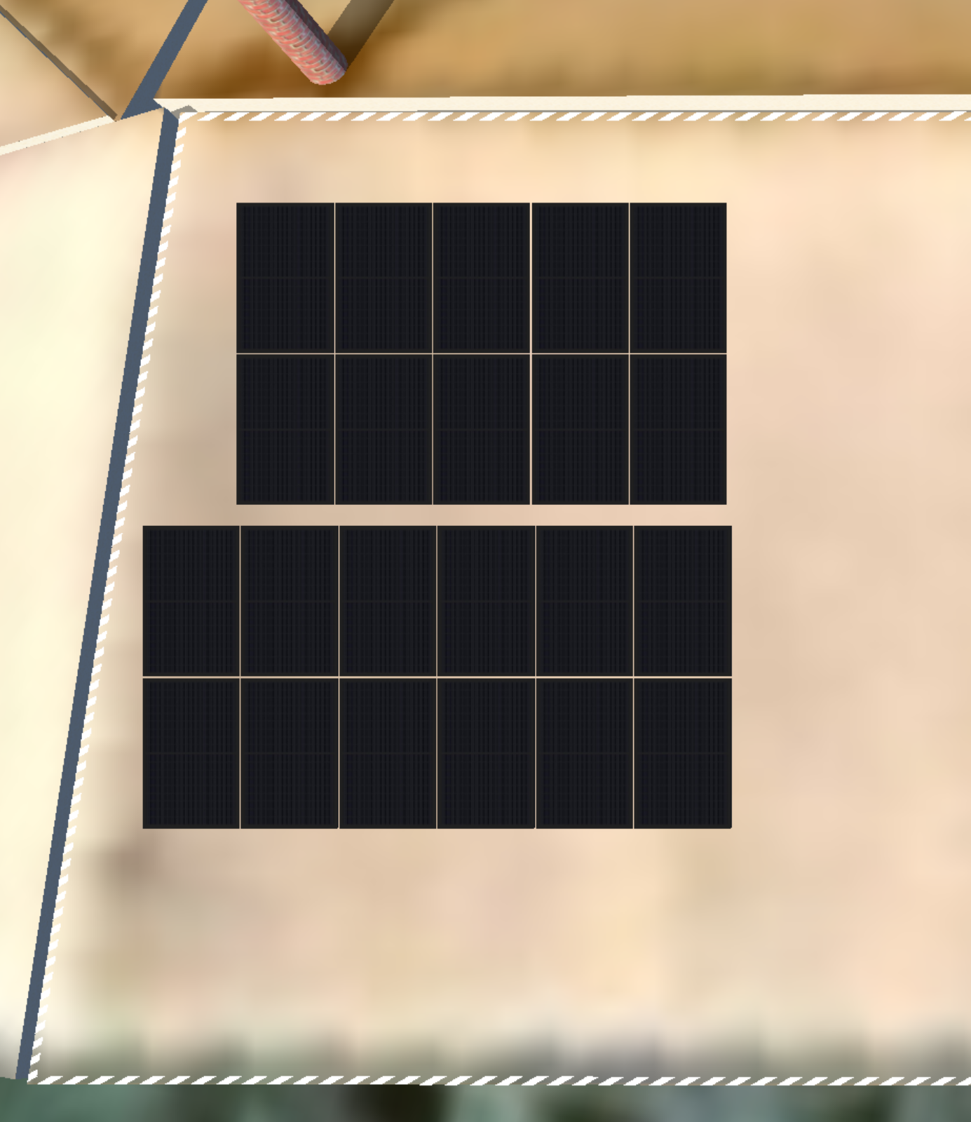

November 7, 2025Nov 7 comment_19880 <-- this is how PVsol mounts/draws the (fixed) onto the roof. <-- This is how I should draw it in PVsol. Along the lines of the seam roof. Is that possible in PVsol? I don't see anywhere where you can adjust the inclination or gradient of your installed panels in the "Module Coverage" option. Please let me know. Thank you. Report
November 7, 2025Nov 7 Author comment_19881 The second screenshot is photoshopped to show what i need to do. I cant make this in PVsol.... Report
November 10, 2025Nov 10 comment_19886 Dear PV Pro, Thank you for your inquiry. Even if it is a roof-parallel system, you select a mounting system with a tilt angle of 0° in the "Module Mounting" tab and select the corresponding reference edge (in our example: edge 2): Report
