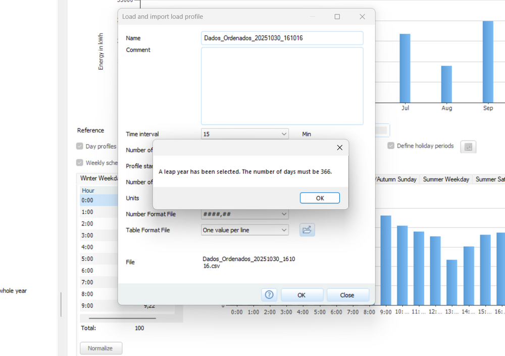

Daniela Silva Posted October 30 Author Report Posted October 30 Hello, This cannot be done. Below is an image showing an error with pvsol. How can we solve this? Quote
hotline_oh Posted November 3 Report Posted November 3 Dear Daniela Silva, Thank you for your inquiry. As mentioned previously, select January 1, 2018 as the start date; the year runs from Monday, January 1, to Monday, December 31: Quote
Daniela Silva Posted November 3 Author Report Posted November 3 Hello, So we have to eliminate December 31st, right? 2018 has 365 days and 2024 has 366.. Quote
hotline_oh Posted November 3 Report Posted November 3 Dear Daniela Silva, Thank you for your inquiry. Yes, that's correct. On 10/21/2025 at 11:08 AM, hotline_oh said: While the software doesn't output simulation results per weekday (only per day, per month, or per year), we understand that excluding February 29th can be detrimental. A workaround would be to remove the December 31st load profile data and import the load profile for 365 days of 2024 (from Monday, January 1st to Monday, December 30th). However, since the software expects 366 days for 2024, select January 1st, 2018, as the start date; this year runs from Monday, January 1st to Monday, December 31st. Quote
