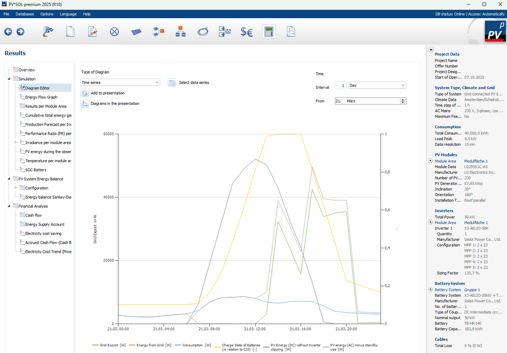

When I activate daily time control, it doesn't show up in the results. See the screenshot of the results: grid input remains 0 kWh.
If this is not correct. Can this be solved in a new software release of PVsol.

The battery discharge to the grid is shown as 0 because this is a DC-coupled battery system. In these systems, PV energy and battery energy are simulated together and not output separately.
You can see in the diagram editor that battery discharge to the grid is still occurring – according to the time-controlled discharge function. On a day with high irradiation in March, the battery is fully charged at midday. Starting at 12:00 PM, grid feed-in occurs, which continuously decreases until 5:00 PM – as the PV energy decreases. From 5:00 PM onwards, grid feed-in increases again, as the battery is now being discharged to the grid. At 9:00 PM, grid feed-in/battery discharge is complete.

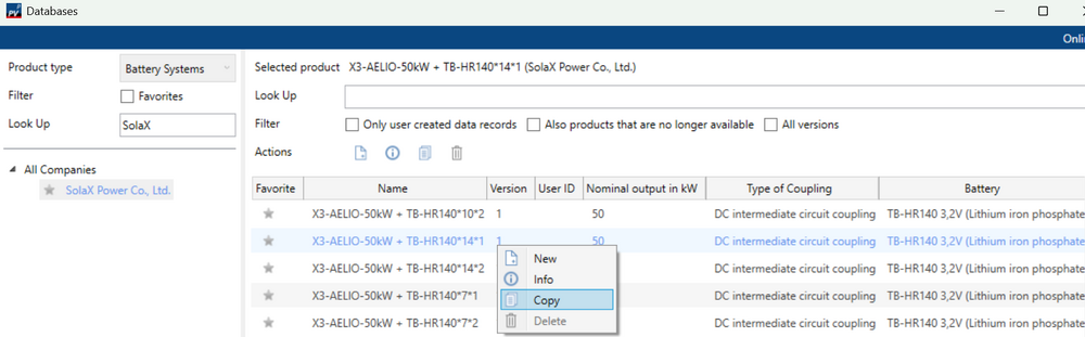

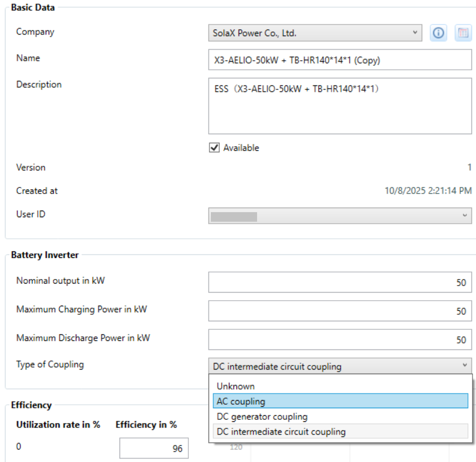

Another option would be to copy the battery system, change the coupling type, and run the simulation with an AC-coupled battery system.
Thanks for your fast response!
Nice! So i make of al my favorite/ most chosen DC coupled batteries an AC version. That will work for now. Hopefully there is coming in the future an new release with more functionalities around this charge/discharge/dynamic tarifs
