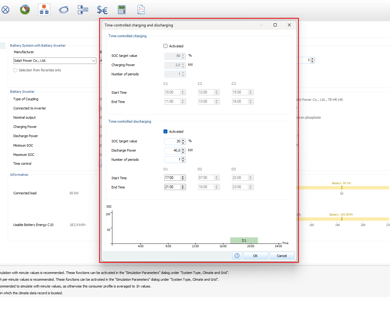

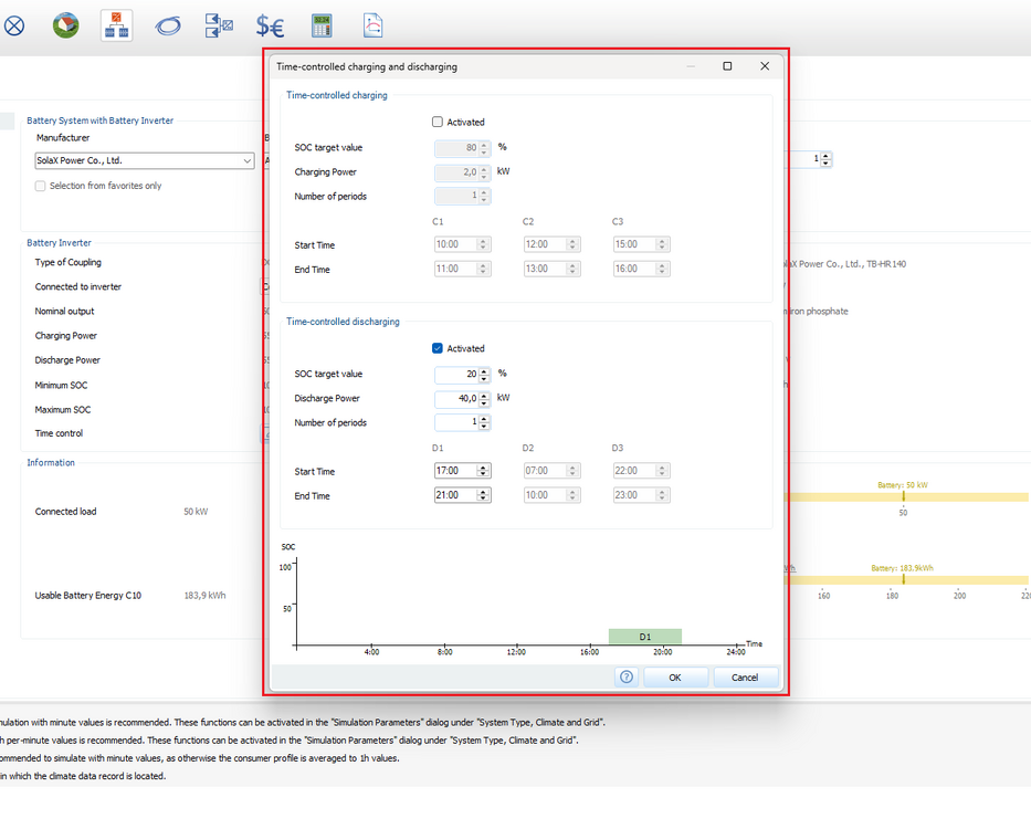

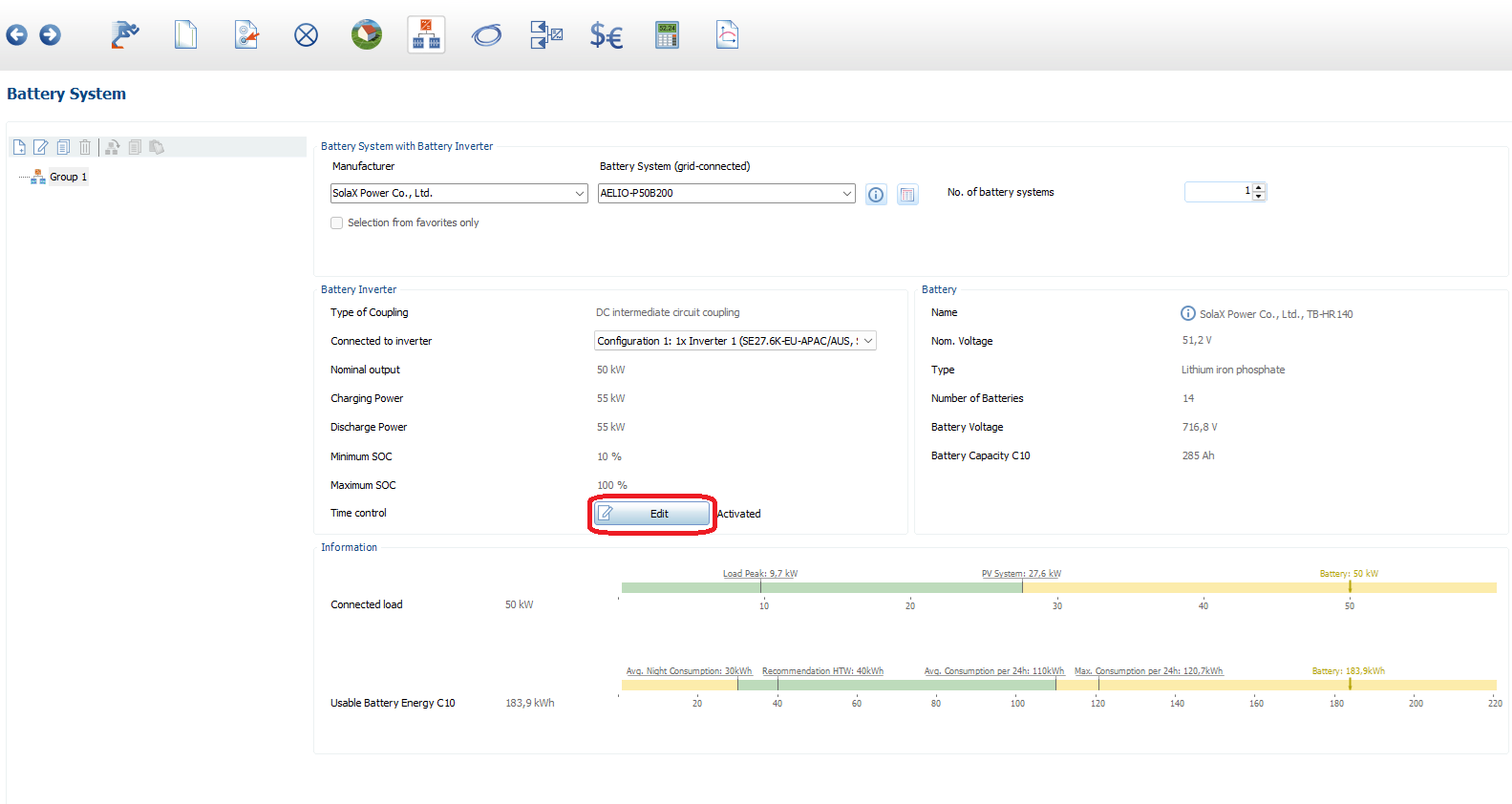

PV Pro Posted October 6, 2025 Report Posted October 6, 2025 I want to calculate in PVsol for a customer what they draw from the grid and what goes in and out of the battery. As I see now, I can only enter daily periodic charging and discharging over the entire year. I'd like to be able to demonstrate to the customer that they use their own power during the winter months, because there's almost no surplus PV power then. I don't want to sell/return power during these months, so only for self-consumption during the winter. Conversely, during the summer months, when there's a lot of surplus power, I'd like to sell/discharge it to the grid (when electricity prices are high). This is usually in the morning from 7:00 AM to 10:00 AM and in the afternoon between 5:00 PM and 9:00 PM. Can this be configured individually per month in PVsol, or even with dynamic tariffs? Or will this be released in a future PVsol update? PVsol does offer a minimum discharge level (SOC%), which is very useful. To have enough left over for our own use. Quote
hotline_oh Posted October 7, 2025 Report Posted October 7, 2025 Dear PV Pro, Thank you for your inquiry. Unfortunately, dynamic tariffs and seasonal time-controlled charging and discharging cannot currently be accommodated in PV*SOL. Our development team has been informed and is working on an implementation. Quote
