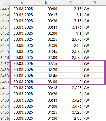

You need consumption data for a calendar year.
With 15-minute intervals, you need exactly 35,040 values. "Four values too many" indicates that four zeros were added to the file due to the spring time change. Delete these four rows:

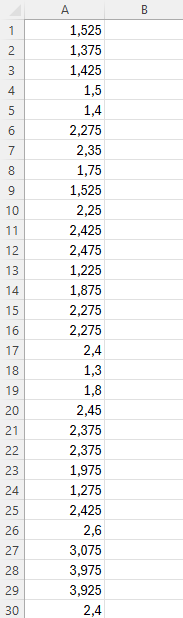

Then delete columns A, B, and D. You only need the raw consumption values, without timestamps or column headers, in the first column of the Excel file:
The error message "No read permission" appears if the load profile is still open in Excel. You must first close the Excel program (or the file) before you can import the file.
