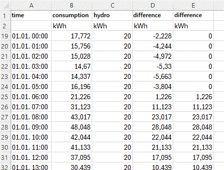

You can also subtract the hydroelectric power plant's profile from your load profile beforehand in Excel and set the negative values to zero. This could look like this:
