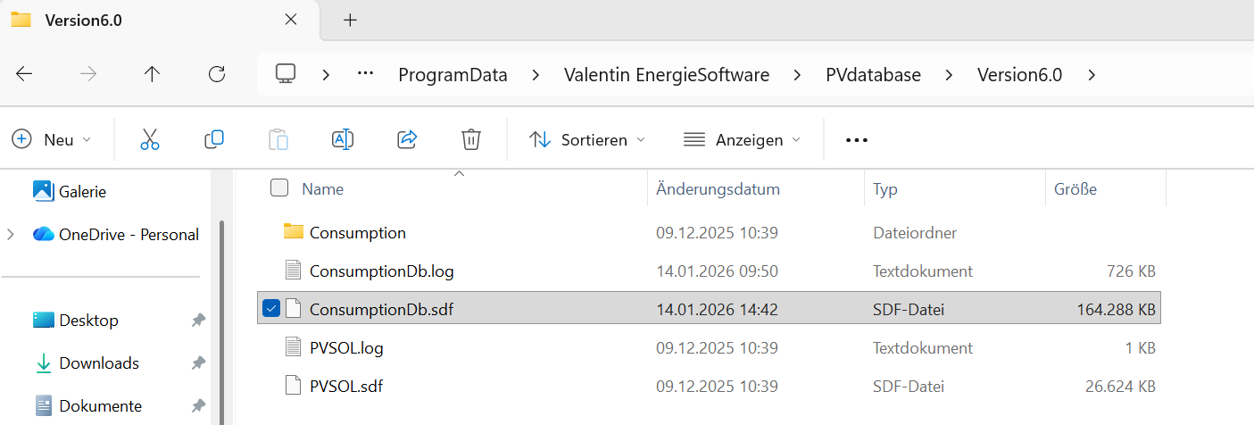

Your imported load profiles are saved in the file "ConsumptionDb.sdf", which you can find in the following folder: C:\ProgramData\Valentin EnergieSoftware\PVdatabase\Version6.0
To use the imported load profiles on another PC, transfer the "ConsumptionDb.sdf" file to the new PC.
