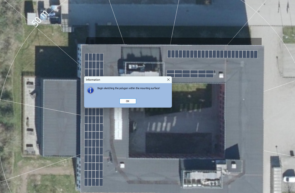

  7. Anders
    3D
    Okay. Thanks. I will like to simulate the shadows. On the roof, there is some technical equipment that I would like to model in 3D in order to see its shadows. I have tried to draw a polygon to illustrate the technical equipment, but I get an error as you can see in the attached image. How is this done? It is a bit of a tricky building I think, so how many panels can you fit on the building? Are there any shading conditions I should take into account in the simulation? surroundings Dagrofa servicekontor new.pvprj

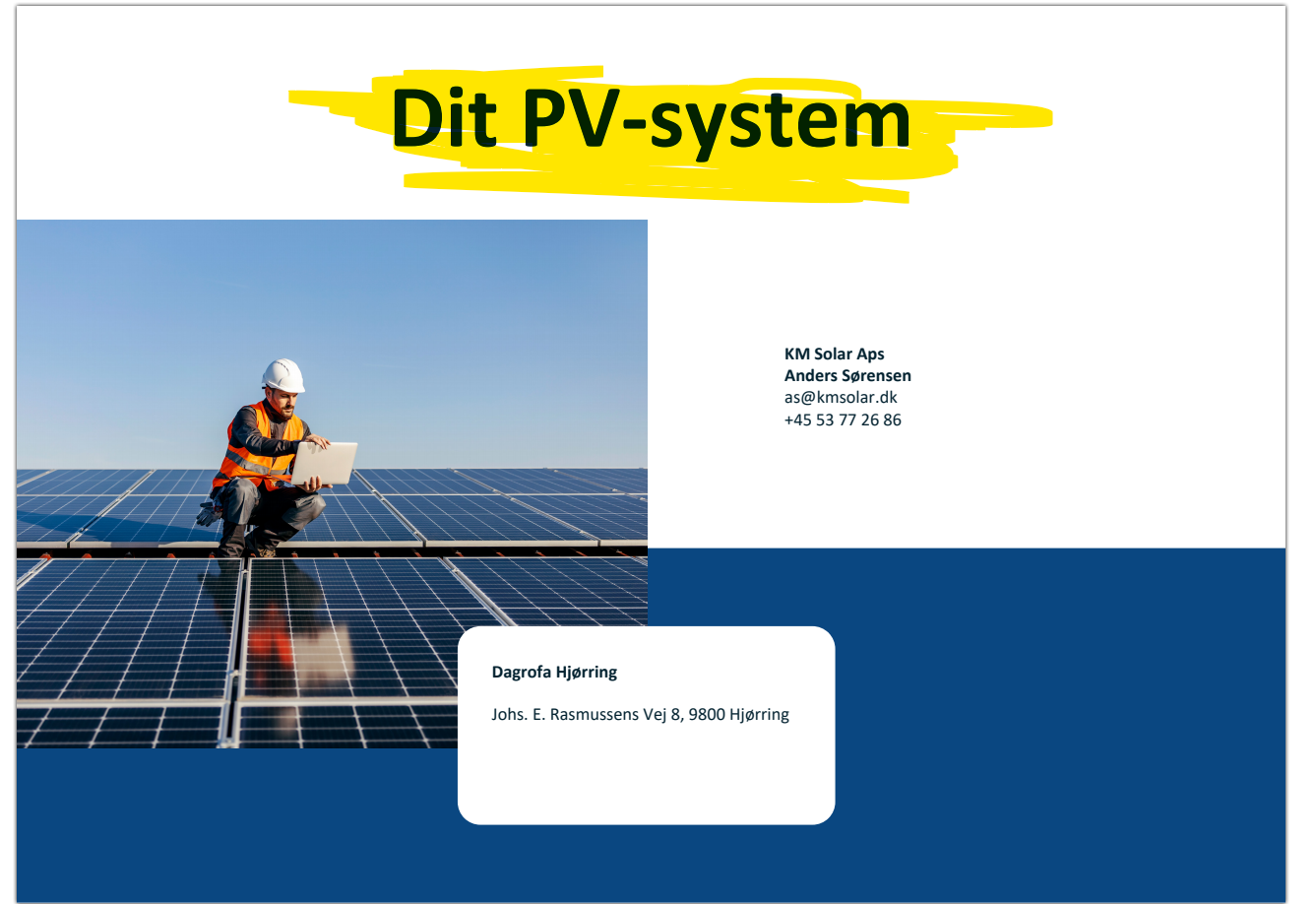

  8. Hello. Can I change the headline and the image on a compact report? I would like to change the headline “Dit PV-system.”
  9. Can I change the headline and the image on a compact report? I would like to change the headline “Your PV system.”
  10. Anders
    3D
    Hello I am still new to PV SOL and now I have to simulate PV on a big Building in 3D for a customer. I don’t know how to do it, since the building is a square with a “hole” in the middle. Can you help with the 3D model of the building? Thank you Dagrofa servicekontor.pvprj
  11. I would also like to now if I can change the picture on the front page in the compact rapport?
  12. Hello. I want to change the headline in the compact customers presentation. For now it says "Dit PV system" How do I do that?
