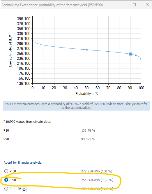

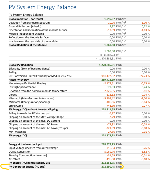

    P50 - P90 results
    Dear, We need a P90 report for our customer. Is it possible to present the P90 results in the presentation of the "PV system energy balance" instead of the P50 results?
