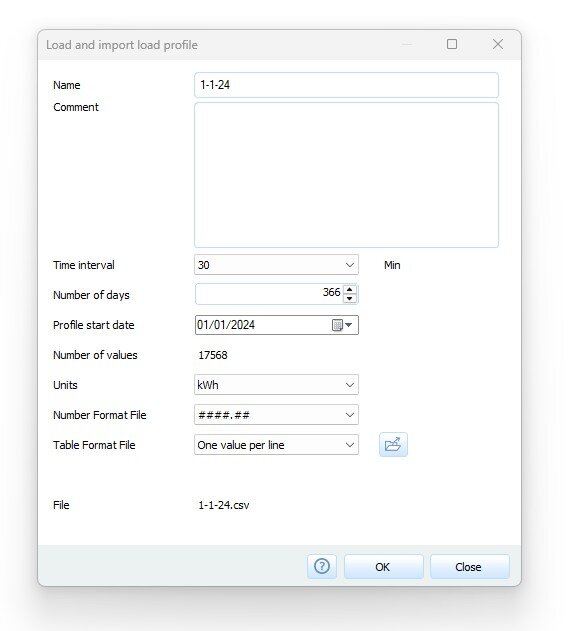

  1. That seems to be the problem! Thank you so much

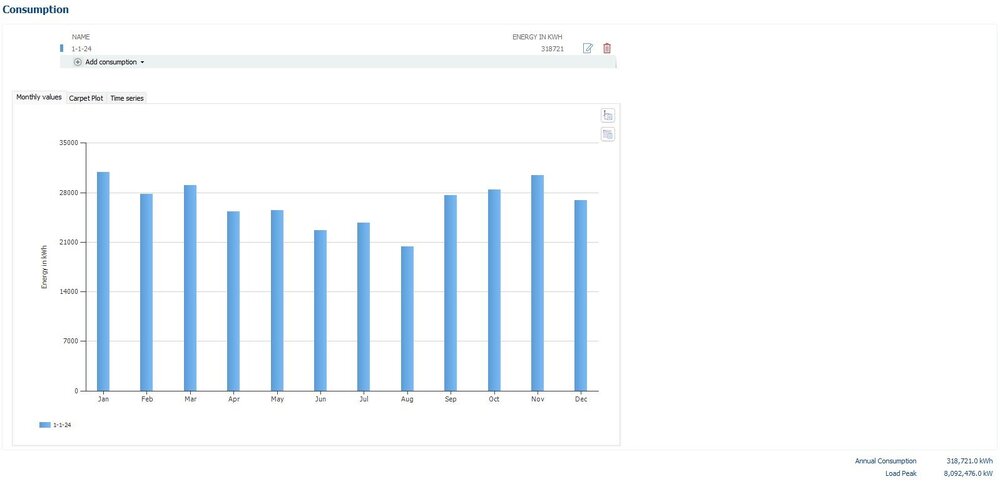

  2. Hi Hotline, a realistic result would be 318721kWh with Load peak 36,4kW (assumption). I think the problem lies on the Data resolution time. Once I import the HHD it changes to 1min from 1h which obviously is incorrect. With Annual Consumption: With Imported HHD: Thanks

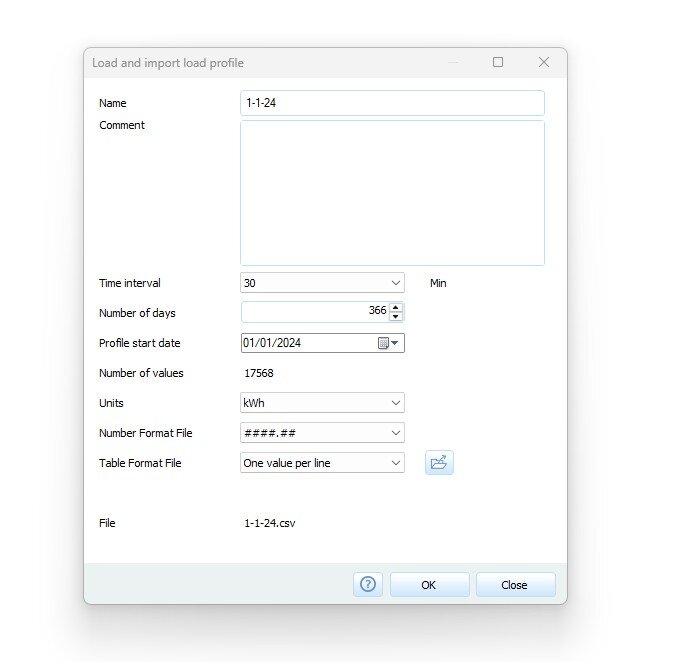

  3. Hi hotline_oh, thank you for your response, unfortunately its not that.. I was testing it to see if the HHD are in kW but they're not. the HHD are in kWh. I uploaded the correct one. But still, even if you change it to kWh the peak is still sky high.
  4. Hi, I'm running into an issue here and I hope someone had the same experience and can help me. I imported the HHD successfully but the Annual Consumption and Load Peak are way to high, which is not correct, as you can see in the pictures. Have anyone else had the same problem and if yes, have you found the solution? My guess is there's something wrong with the HHD but cant figure out what. would be grateful 1-1-24.csv
