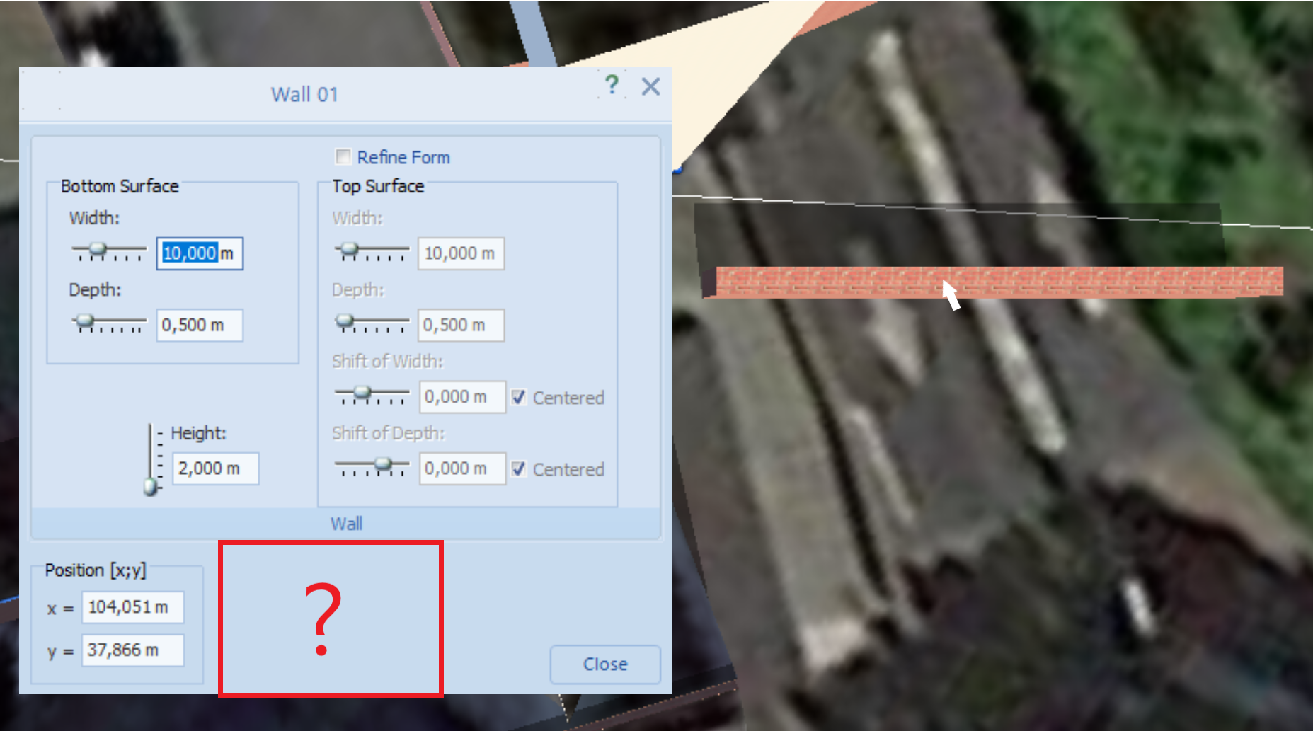

  1. Dear, When i select the WALL function in: tab OBJECT VIEW then the 3rd icon WALL, then again 3rd icon WALL. I can drag this wall to my plane. but after that i want to adjust the orientation. right mouse click on the wall > EDIT > But there is no possibility to change the orientation. Only the coordinates are visible. Please give me advise how i change this orientation or solve this issue in the next update please. Thanks. Kind regards, M.Haaksema (Samenstromen)
