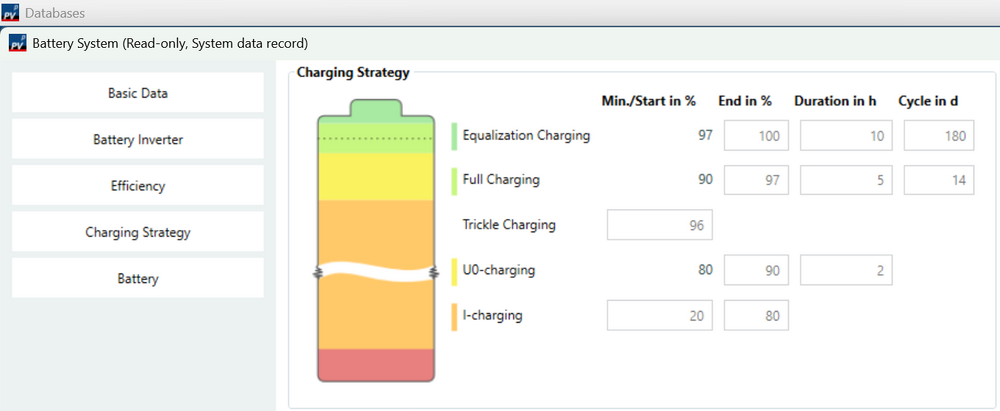

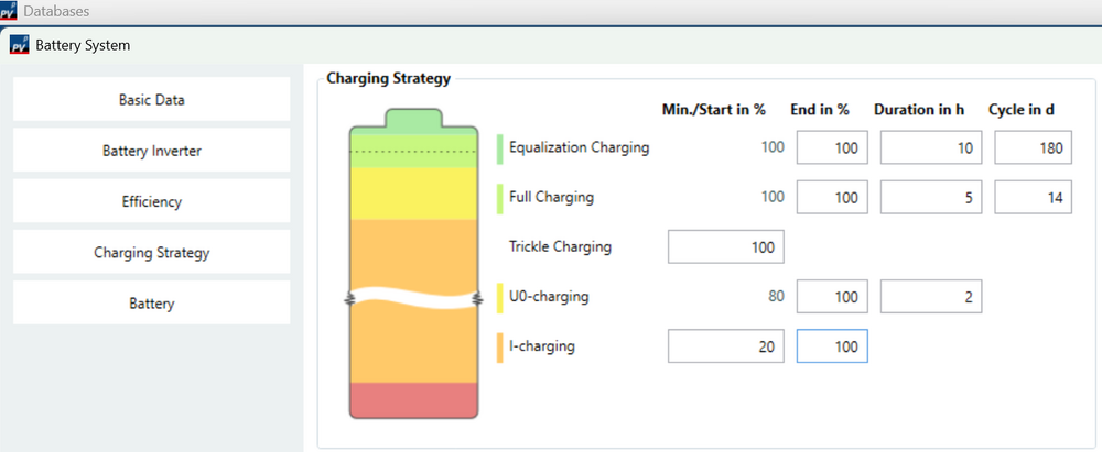

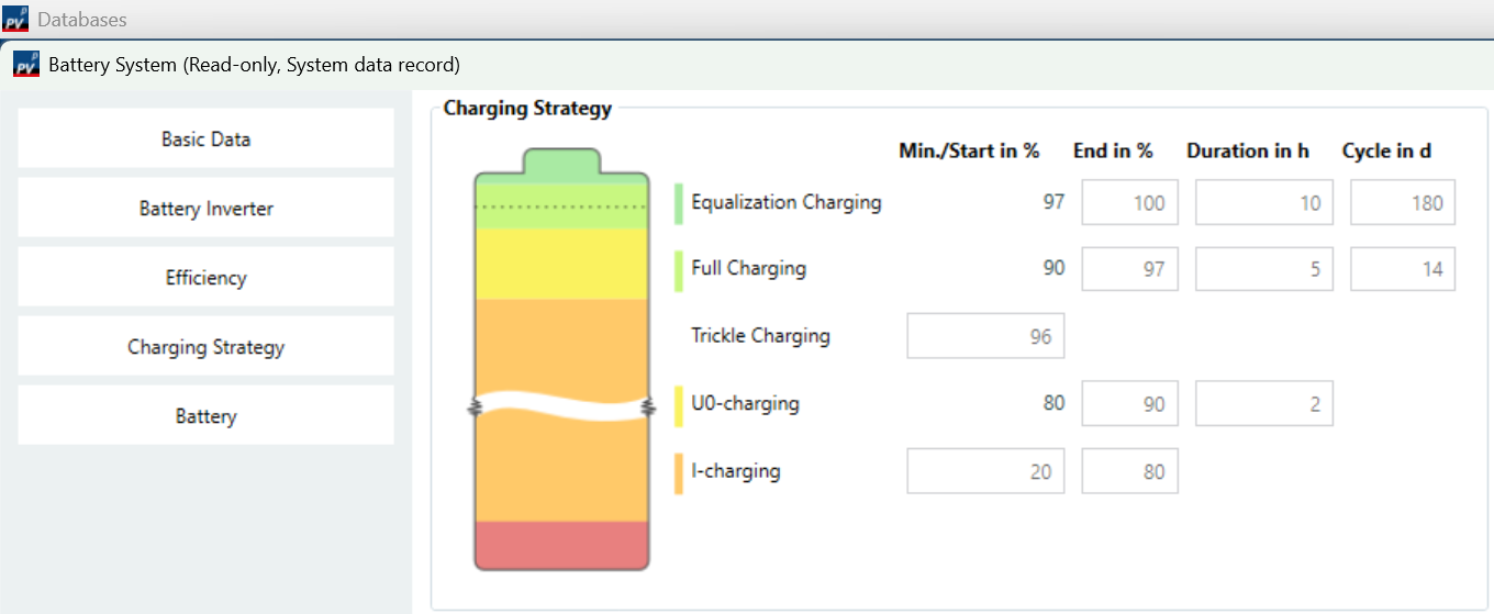

  1. Hi,
    how can I charge the battery only from the SUN?
    If there is no sun, the battery remain empty!
    Thank you in advance.
    Codrin
    1. hotline_oh
      Dear CodrinSomesan,
      The battery is primarily charged with PV energy. Only in exceptional cases is the battery charged from the grid. Further information on charging plans can be found in the help section:
      https://help.valentin-software.com/pvsol/en/calculation/battery-systems/charging plans/
      If you want to prevent the battery from being charged from the grid, copy your battery system, save it again, and set all charging types to 100% so that only C-charging/I-charging takes place:
      If you have any further questions, please send us the project file (*.pvprj) and we'll take a look at it.
